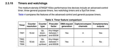

‎2024-08-28 2:44 AM
Yes,
I see this in the datasheet of STM32F103x8, STM32F103xB microcontrollers in the Table 4 (see Figure 2 below).
Table 4 also shows that STM32F103xx have TIM1, 2, 3 and 4. TIM3 and TIM4 not included in RM0008 Reference manual. Why?

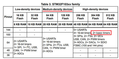

‎2024-08-28 3:15 AM - edited ‎2024-08-28 3:16 AM
The information is provided in the datasheet.
The device stm32f103xb is a 128kB of Flash device which is the medium-density.
As you can see in Table 3 from the datasheet, the two basic timers TIM6 and TIM7 are available only on High-density devices.
Hope it does answer your question.

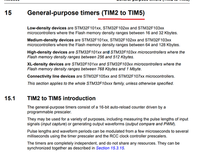

Yes, TIM3 and TIM4 are available, but why did TIM3 and TIM4 not include in RM0008 Reference manual.
‎2024-08-28 3:32 AM
They are available as General-purpose timers TIM2 to TIM5:
But that was not your original question. Please accept as solution the comment that answered your question.
‎2024-08-28 3:39 AM
Thanks for the explanation. I'm just learning English so I didn't pay attention to the word "to" between TIM2 and TIM5.
