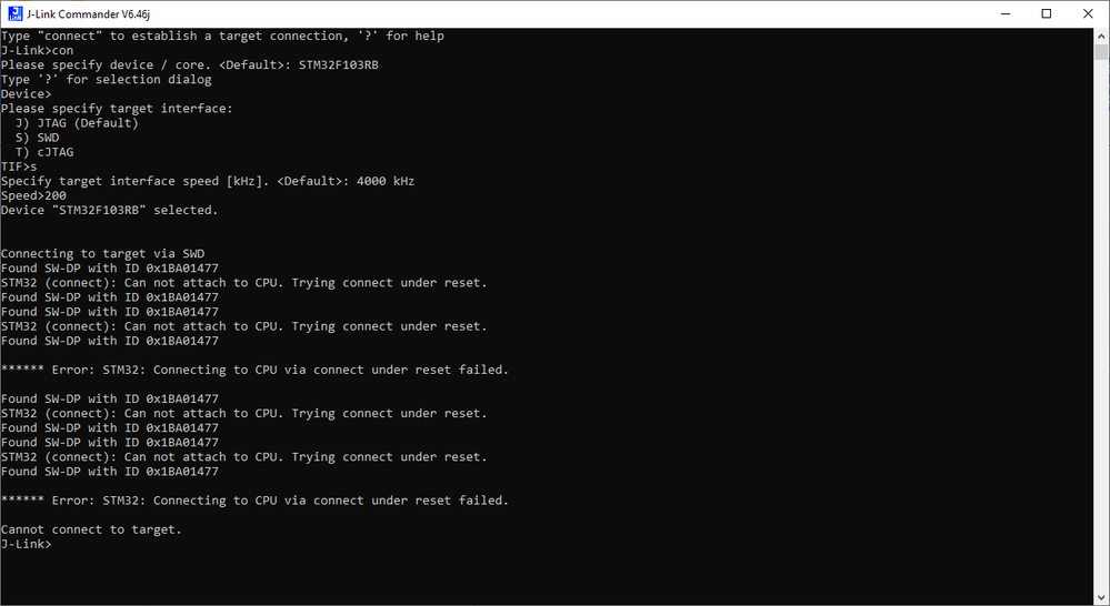

I am using an STM32F103RB MCU in a specific Hardware design.
The Hardware was always working fine (it is a final product of medical customer) until I flashed a software which implements the stop mode (deep sleep mode) management (by setting the SLEEPDEEP bit in the System control register (SCB_SCR) and configuring the PWR_CR register).

In the Software after calling WFI instruction (wait for interrupt) to wait for an interrupt to wake-up the micro-controller, it still sleeping for ever.
In debug session by pressing next step in IAR, I can go out from deep sleep mode.
When I go out from debug session, I can't connect anymore to the micro-controller and I can't flash it anymore.
I guess that because always when I power on the Hardware, the CPU goes directly in deep sleep mode.
I have the issue as described in the screenshot below:
I am really stick with this and I look forward your help !

Actually, I resolved the issue! The problem is the NRST of the MCU is not connected to the RESET pin of the J-Link connector.
Connecting that, works well and I can flash the MCU with no problem.

Connect Under Reset requires the NRST actually being wired on the JTAG/SWD interface
The BOOT0 HIGH trick can be more helpful as it stops your code from running at the next power up or reset.
