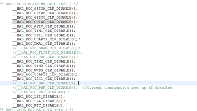

1) Set all GPIO pins to Analog
2) Disabled all peripherals manually:
3) Enabling PWR_CLK decreased current consumption by a little
4) Break PWR LED and PC13 LED
5) All serial wires disconnected

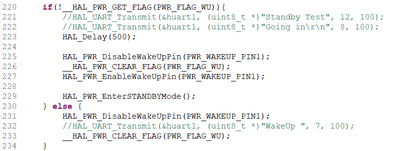

This is how I enter Standby Mode:
I powered my board using a 3.7V Lipo battery and my multimeter triggers 0.404mA.

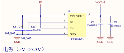

3) The voltage regulator on my board has the markings "LB33 E1A2". According to a schematic I found online:
This regulator has a quiescent current of 90µA. But, I'm powering through the 3.3V pin, so it should bypass the regulator anyways.
