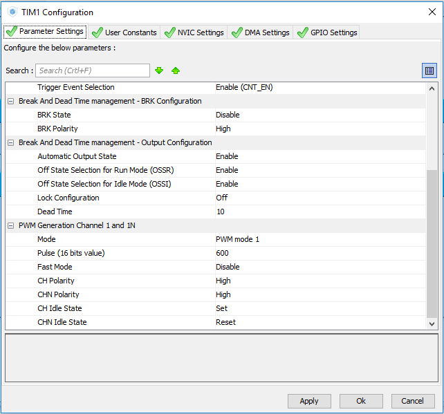

I've created two PWM with a 50% duty cycle using STM32F103 and its timer8. Now I would be grateful if you tell me how to shift one of the PWMs?

As I said before, I produced two similar PWMs with a 50% duty cycle. Now, I would like to know how to shift one of the PWMs with 180 degree relative to other one?

Do you need complementary signals?
Then configure TIM CH1 and CH1N and the break/dead time like this:0690X00000607MYQAY.png
