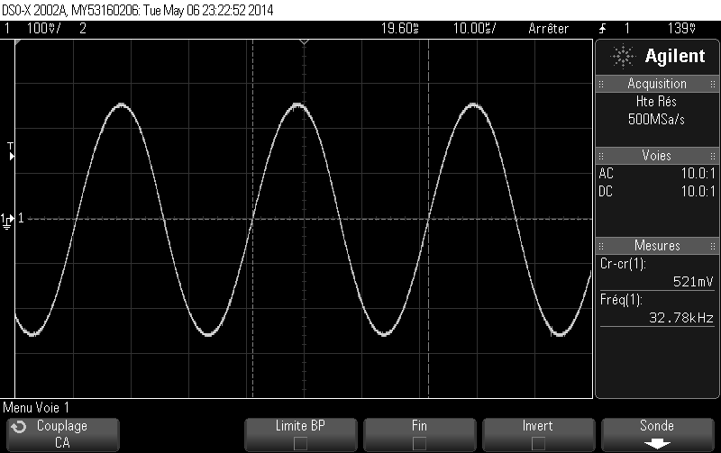

hello,
I am in the
development of a new
application with a
STM32F051R8
I have a big
problem with
the accuracy of the
RTC:
I
used both
the
quartz
advocate
in the
note
AN2867
application.
I initialize
the
RTC
well
with clock
LSE
I
check
the integrity
of the signal
source
to the oscilloscope
, however
I see
some
burst
even
changing
repeatedly
torque
quartz
capacitor
I have
the same problem
on the prototype board
made
​​for our
machine
on the
evaluation board
is
why I
excluded
a problem of
PCB
design
After
24 hours
I
observed
a
deviation
which varies
from 60 to
90 seconds
This deviation
is even more important
if I use
the
timer
2
to generate an interrupt
every
0.1
ms
I do not see
what can
interfere with
the oscillation of the
quartz
or registers
of the
RTC
, did
you
meet with a
similar case
Thank you
for your help.

    The capacitance of the scope probe may affect the Xtal oscillations.
    If the device has the functionality - get he device to output the LSE on an IO pin and check that with the scope.

    yes ocscilloscope is a bad thing to measure signal, it s just for check the frequency, but level is bas, sure.
    I use 6,8 pf +/- 0.25 pf , perhaps i buy in other distributor

    Attachments :
    scope_4.png : https://st--c.eu10.content.force.com/sfc/dist/version/download/?oid=00Db0000000YtG6&ids=0680X000006I0qu&d=%2Fa%2F0X0000000bfE%2FYyNh4SF6So1vE3BMZFAHCbcEWG3sum9sXQOrIwPXSGM&asPdf=false

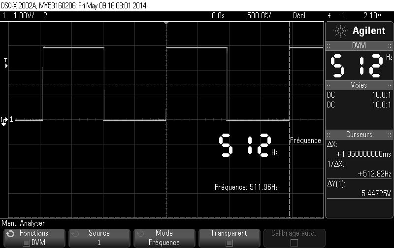

    May 9, 2014
    Posted on May 09, 2014 at 10:18
    I give you
    some
    news about
    the problem of
    stability
    First
    I rewrite
    my code for
    just use
    the
    RTC
    péripheral
    to
    make sure
    there
    was
    no
    interference
    with other peripheral.
    I activated
    the
    512
    HZ
    output
    to measure the
    signal
    I bought
    high-precision
    6.2
    Pf
    capacitors,
    the
    measured frequency
    was 404
    Hz:
    even worse than before
    Capacitors
    with
    6.8
    pf
    I have
    a frequency of
    520
    Hz
    In any
    case
    the
    two
    signal
    as
    very
    unstable.
    I said that
    I use
    quartz
    with
    capacity of 6
    Pf
    as recommended by
    ST.
    And
    I
    test
    the 12
    pf,
    and:
    Very stable and good frequency.
    In conclusion
    no
    software
    problem
    but I
    'll order
    the exact reference of
    quartz
    in  BOM of
    discovery
    noard, and I
    redo the
    test.
    I
    keep you informed
    Sorry for my english.
    sylvain535
    May 27, 2014
    Posted on May 27, 2014 at 08:33
    finally to close the post,
    and after much
    trial
    , the best accuracy was found whith 12 pf quartz and 12 pf capacitor.
