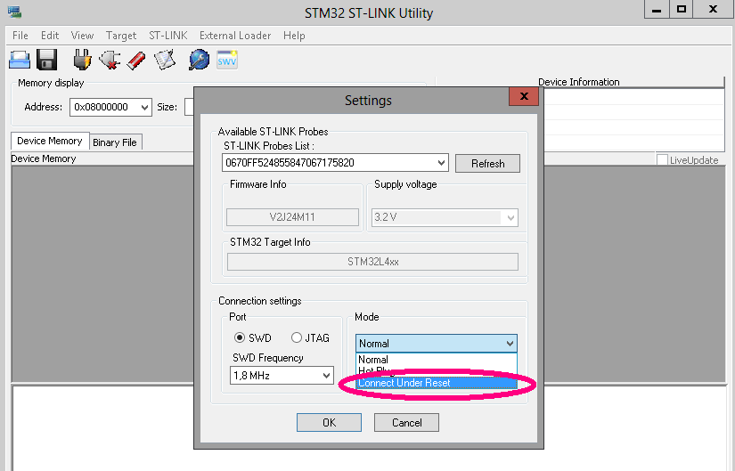

I want to use PA14 for programming (which i am currently using) and after programming once controller resets i want to use same pin as UART 2 TX pin. How can i achieve this ?

You mean programming through SWD, from STLink or similar?
You'll need to use the ''connect under reset'' option for programming,
- or equivalent in your programming environment - and connect the respective STLink line to NRST.

Well thanks for the info. By default i have that selected. My question is can i configure PA14 as SYS_SWCLK and UART2 TX pin in CUBE. I have seen pin stacking function in ST Cube. It is possible from cube ?

I don't Cube so I don't know (I don't even know what pin stacking means). But you can simply set it as UART2_TX, and when programming, during reset it will function as SWCLK (that's why you need the connect under reset for programming).
You won't be able to debug through SWD, though.
