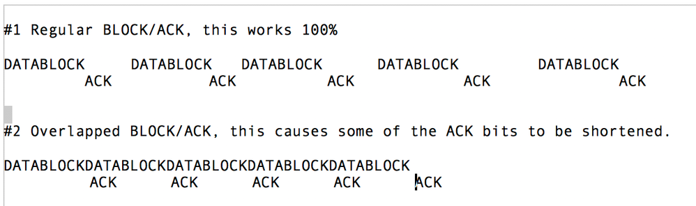

It's a block protocol, with the remote board sending 256 byte blocks and the F030 board sending ACKs (hex 0x06) along the way.
It had worked fine, when the ACK from the F030 was sent after a full block. When sending while there was still incoming data, the start bit of the outgoing data was suddenly shortened a bit, resulting in incorrect data being received in the remote end.

I've sent several MB of data over the link with no issues, as long as I keep it as "half duplex" and wait until data has been received before sending an ACK byte back.
So, the link itself is perfect and stable.
This is a design that has been in production for over a year, but I just recently changed the protocol slightly to speed it up, by sending blocks in burst of 10 and "picking" up 10 ACK's in the other end. That did NOT work, due to the corrupted transmit bytes.
‎2019-04-20 4:14 AM
Note that is is not all of the ACK's that are corrupted, is roughly 1 in 10 or 20. It depends on the timing or bits coming in on the RX
Here's how it is sent:

Now this is completely out of normal. The 'F0 are here for quite some time and if there would be a hardware bug in duplex UART, I'm sure we'd already know about it.
So it's time for desperate measures:
- read out and post content of the USART registers (all of them), at any point, say at the beginning of communication, for to have something to chew on
- cut the trace from Tx to modem, insert a resistor say something between 100R and 1k, and connect the LA on both sides of that resistor
- reduce the program to minimal but complete compilable form which still exhibits the problem, and post it
Or... just revert to the previous variant. Better slower but working, than fast but buggy.
It may be indeed a hardware issue, not in STM32 itself, though.

Indeed a different HW issue, Pavel. It was false alarm, obviously.
I already have serial resistors between the modem and CPU, 1k.
When going to setup a scope test and grabbing the erroneous byte, as suggested bi KIC8462852, I realised that the latest batch of boards, had 10k resistors mounted instead of 1k.
This caused signals to float up a bit and bits to be detected incorrectly. Oddly enough this only happened when I was receiving data at the same time, and it happened simultaneously at the receiving end AND the analyser, so now, at least I know that the thresholds are very similar ;)
So, as always, never trust a HW you haven't assembled (or triple inspected) yourself.
