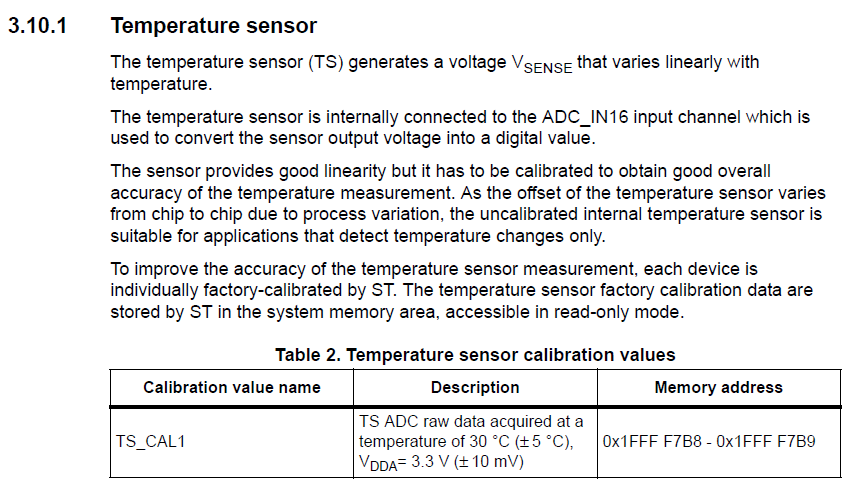

the examples i found are only for other stm chips with 2 calibration values
‎2022-06-08 2:57 AM

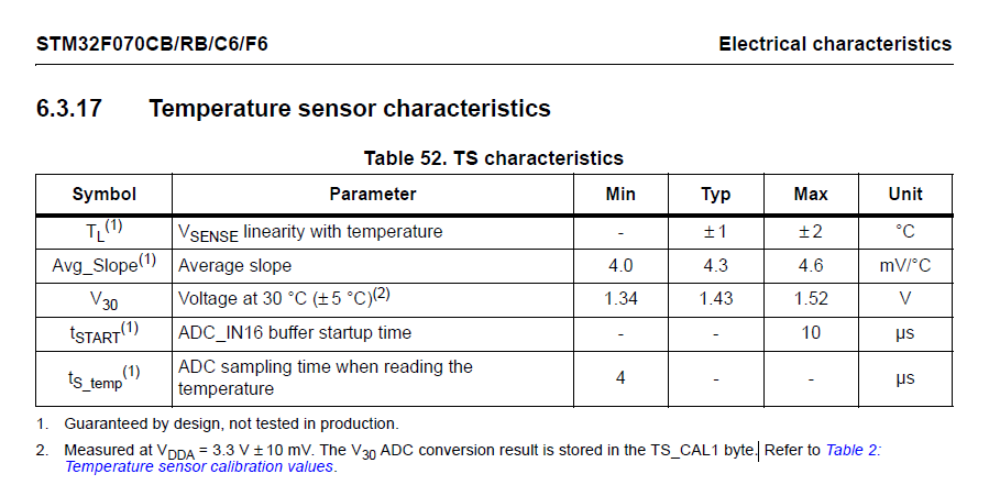

Have you looked at the datasheet:
‎2022-06-08 3:25 AM
yes i did but the calculation i tried is wrong
i think its much easier if the datasheet gives some examples

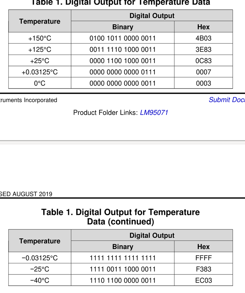

for example from the datasheet of a lm95071
this makes it clear how it has to be calculated
so can you tell me the hexvalue of the ad at 0°C with a vdd of 3.3 V ?

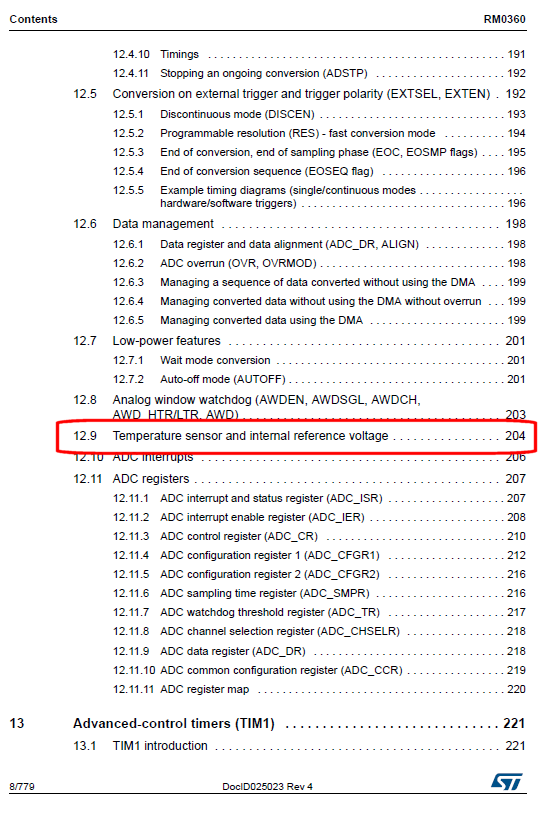

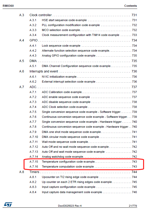

Don't forget to also look in the Reference Manual - that's where programming details are to be found (the datasheet concentrates on physical characteristics):
‎2022-06-08 5:00 AM
thank you very much
that was the the hint i was searching for
