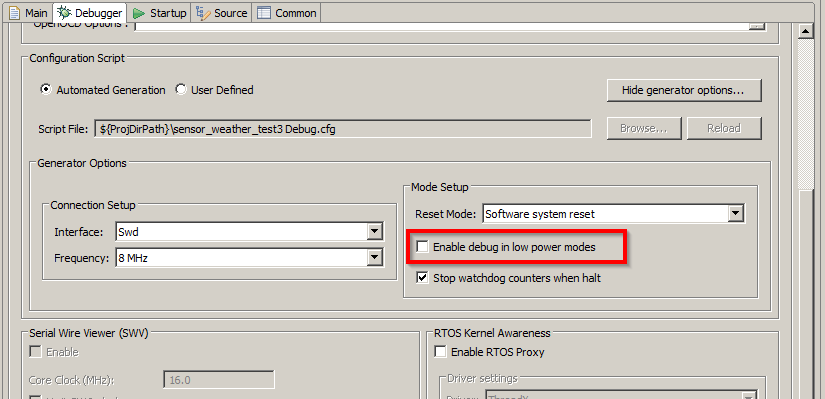

I would like to put STM32F030K6T6 into STOP mode (low power mode), in which there should be current consumption around 5 μA.
But whatever I do the current consumption is around 450 μA in stop mode.
There is basically nothing else on the PCB, it's as simple as possible.
The board without MCU consumes 7 μA, that is quiescent current of LDO. So in the end I would expect to get 12 μA (7 + 5 μA).
When I place there MCU the consumption is around 2-3 mA in normal mode and 450 μA in stop mode.
All pins are set to analog input with no pull-ups, which is recommended config. All peripherals are disabled (like ADC, IWDG, I2C, SPI, timer, etc.). Only RTC is enabled.
I tried it with all pins set to output, it did not help either.
What do I do wrong?

2022-03-19 12:41 PM
I put it aside for couple of days. Now I got back to it.
And it works OK without changing anything. 20 μA in stop mode (LDO + MCU), and 2.6 mA in run mode.
When I flash firmware, disconnect SWD connector, push reset, it consumes 450 μA in stop mode.
I have to completely disconnect power, and connect back power, after that stop mode consumes 20 μA.
Then I found an option in flashing settings "Enable debug in low power modes" which is checked by default. I unchecked it and now it works even after flashing and I do not have to completely disconnect power.

2022-03-17 1:37 PM
Set DBGMCU_CR to 0 and disconnect the debugger physically.
2022-03-19 12:41 PM

2022-03-19 12:43 PM
Thanks for advice.
I found the culprit. It was not the DBGMCU->CR register. See my answer.
