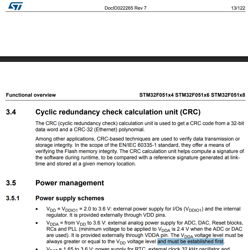

STM32F030 datasheet: Misleading VDDA vs VDD sequencing description?
Split from: Power Supply for STM32F030 Cortex TSSOP20 VDDA and VDD pin; specifically this post.
@TDK wrote:
that satisfies the condition.
But only the "VDDA >= VDD" condition - it doesn't satisfy the "VDDA must be first" condition.
As noted, I suspect that the 2nd condition is incorrectly stated; I guess it should say, "VDD must not come after VDDA" or similar ?

Andrew Neil
October 30, 2025
@mƎALLEm  Can the misleading datasheet wording be flagged for clarification?
mƎALLEm
October 30, 2025
Do you mean the statement "must be provided first" ?
Andrew Neil
October 30, 2025
Yes.
mƎALLEm
mƎALLEmBest answer
December 11, 2025
Hello @Andrew Neil ,
The fix will be available on the coming versions of the document.
