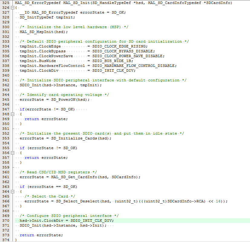

Hi, I've been trying to get SDIO working on the STM32F4 Discovery board. I've wired up the SD card and created a basic project using CubeMX.
The MX_SDIO_SD_Init() function completes successfully but I cannot get the HAL_SD_ReadBlocks function to work. I get SD_ILLEGAL_CMD when the SD_CMD_SET_BLOCKLEN command is sent. I've lowered the SDIO clock speed by setting the SDIO_TRANSFER_CLK_DIV define to 0x50 ( 0x76 is 400kHz ) but I'm still have issue. Anyone have this working?

    Just a bit of an update. Although I though I was lowering the clock speed of the SD clock by changing the SDIO_TRANSFER_CLK_DIV define. It was actually being set to 24Mhz before leaving the HAL_SD_Init function. This happens right before the return at SDIO_Init(hsd->Instance, hsd->Init);
    The hsd->Init struct contains all 0's so the ClockDiv field is getting set to 0, so clock is being set to 48Mhz/(0+2) = 24Mhz.
    I added the line hsd->Init.ClockDiv = SDIO_INIT_CLK_DIV; (Line 370) just before the SDIO_Init at the end of the HAL_SD_Init function to keep the clock speed at 400kHz. I also have SDIO_TRANSFER_CLK_DIV (stm32f4xx_ll_sdmmc.h) set to 0x76 ( 400kHz ) for my testing also.
    All operations seem to be now working at this speed, no more CRC or timeout errors. I have a temporary SD card wired to the F4 discovery board and my wiring may be too long but at least I can work from this working low clock speed and figure out the rest. Hope this helps someone, I've been a few days trying to figure out why it wasn't working.

    I dug around on this forum a bit more, and a summary seems to be:
    1. Once the SDIO write is enabled, the FIFO needs data very quickly. However, it is not possible to preload the FIFO and underrun errors happen if you do not get enough data into it fast enough.
    2. The obvious cure is to enable Hardware Flow Control, which holds back the write process if there is insufficient data available, but this feature is flawed in the F4xx devices and the errata sheets states that it should not be used. It is not mentioned in the errata for the F7xx devices which I am using. I turned on Flow Control and was able to successfully execute the test code with the SDIO clock set at full speed (24MHz), which had until then stubbornly refused to work.
    3. Some people say that the underrun problem does not occur if the SDIO is fed using DMA; others seem to still have problems with DMA. I am using non-DMA routines, but so does the ST FatFs_uSD example code (which works fine).
    4. I have no idea why the ST example runs correctly on my Disco board whilst nominally the same code embedded in my own program does not. I have replicated the example scenario as closely as I can and the debugger window indicates that both the configuration registers and the parameter values entering the HAL_SD_WriteBlocks routine are identical. I can only assume that something, somewhere is ''distracting'' the processor at the critical moment, but what it is is not apparent (I have disabled everything non-essential).
