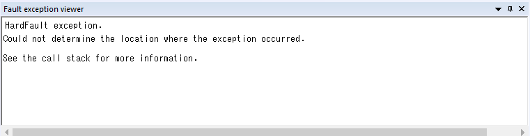

Shouldn't it be loading the CONTENT of the vector .
The vector table does not contain executable code.
Step the transition in the debug.
Instrument and print content to understand what the MCU sees
Have a working HardFault_Handler so you can see if it ends up there.
I would setup SP and SCB->VTOR on the application side

I found that if I separate the bootloader and application programs and run the bootloader only program, I get into "jump main()"and then a Hard Fault error. Is this related to your comment?
