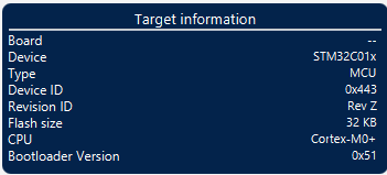

I have some strage problems trying to access all 32kB FLASH on this chip.
If I run a program in the first 16kB of the flash space, it runs perfectly and I can read and write the full 32kB of flash. Reading and writing the full flash is also possible from STM32CubeProgrammer.

This is the result when STM32CubeProgrammer reads the chip:
This is when STM32CubeIDE reads the chip
why do we see different available sizes with different tools?

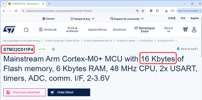

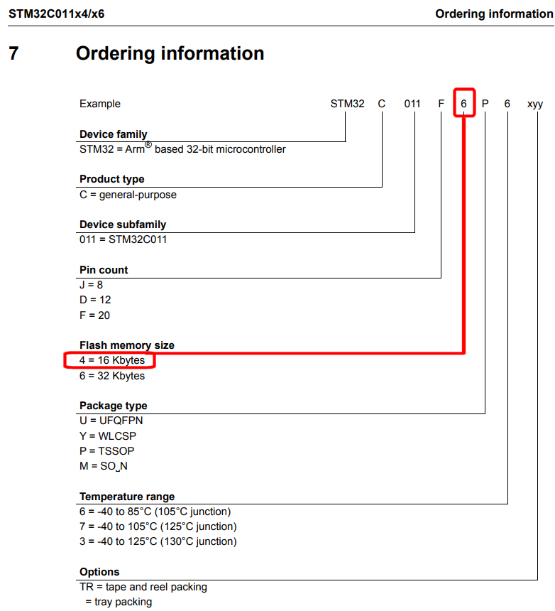

STM32C011F4 only has 16K of Flash:
https://www.st.com/resource/en/datasheet/stm32c011f4.pdf

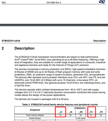

Although the F4 and F6 are the same die, the F4 has only 16 kByte of flash - officially. The extra 16 kByte might not be tested, might even be defective or slightly out of specs. Some tools might allow use of the extra flash, others might strictly stick to the advertized flash size ...
