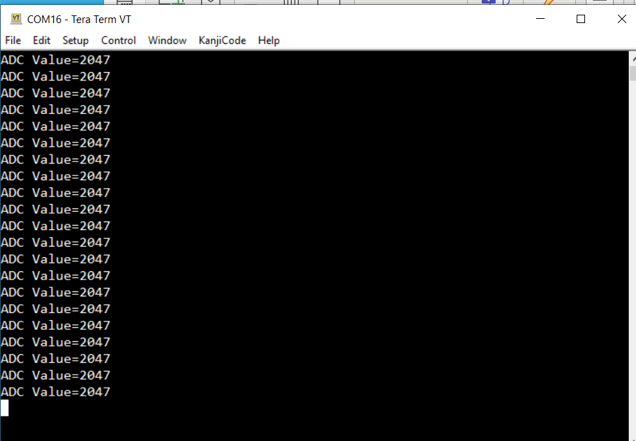

    one more question! I use this code to get the data ADC and transmit it but I can't see my data on Tera Term, I see my data in live Expression but not in Tera Term so most probably problem comes from Transmit part!! I would be happy if you take a look at the code that which part might be wrong.(STMG01291)

    RomainR.
    December 13, 2022
    Hi MFara.4 (Community Member)
    You must convert your variable readValue in Ascii Char to display it in any terminal.
    Before transmit it with HAL_UART_Transmit.
    As an example below:
    Best regards
    #include <stdio.h> // for sprintf usage
    static char adc_buf[16] = {0};
    static uint32_t adc_len = 0;
    /* Convert in array of ASCII char and compute array lenght */
    adc_len = sprintf(adc_buf, "ADC Value=%d/r/n", readValue);
    /* Transmit Array */
    if (HAL_UART_Transmit(&huart1, (uint8_t *)adc_buf, adc_len, HAL_MAX_DELAY) != HAL_OK)
     Error_Handler();
    In order to give better visibility on the answered topics, please click on 'Select as Best' on the reply which solved your issue or answered your question. See also 'Best Answers'

    RomainR.
    RomainR.Best answer
    December 13, 2022
    Sorry.
    I made a typo error in line below (/r/n vs \r\n):
    Change it as follow:
    adc_len = sprintf(adc_buf, "ADC Value=%d\r\n", readValue);
    Otherwise this code works very well (see screenshot below)
    Check your hardware connection.
    Check your terminal settings baudrate, word length, parity and stop bit must be aligned between USART Initialization and your terminal.
