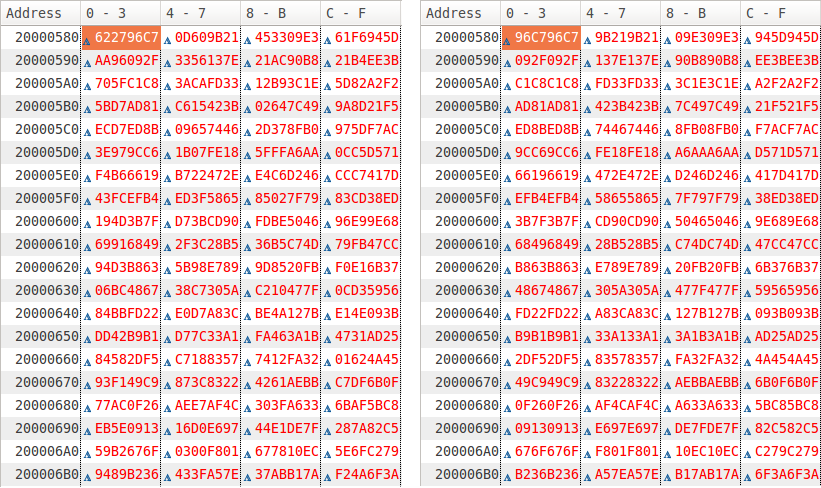

So I just changed my code to use word (32-bit) transactions. Previously I had word on internal memory and half-word on my SRAM external memory.
When I write the memory with one 128-word DMA transfer, and then read it back with another DMA transfer, the memory is not as expected.
The data read back is correct for the most significant 16-bits, but the least significant 16-bits are read as the same as the most-significant.
Here's my initialisation for the DMA:

I've attached an image of the memory I see, before writing (on the left) and after reading back from the memory (on the right)
Posted on November 04, 2014 at 09:18
Could you read out the external memory after the first transfer?
Could you clear the internal memory between the transfers? Any change in the readback values?
Can you perform the transfer using the processor, first 16-bit, then 32-bit?

So I've solved the problem, and it turned out to be a combination of things:
  1. A sneaky, intermittent solder fault on one of the SRAM data lines. I had tested them all to rule this problem out, but it kept showing up, probably every time bumped the board, or when I flipped the board to check soldering.
  2. Incorrect memory timings. I had them configured as per the datasheet, but my circuit layout was causing some timing delays, etc, and so I have to run the memory bus a bit slower than normal. I had tried running them as slow as possible, but the solder problem listed above made me think it wasn't working, so I started chasing ghosts in the code.
  3. Just to be sure, I added some code to explicitly disable the SDRAM chip to avoid clashes with the SRAM (although this causing any problems I had seen).
  4. I got rid of the FMC clock output (that wasn't necessary for SRAM, but will be needed for FPGA block RAM communications when I get to that point) and reconfigured for a minimal SRAM setup.
Everything is working fine now with the FMC and DMA configuration!
