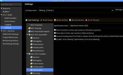

try : set optimizer -O2  , in IDE -> project-> properties
see:
For F103 with USB->CDC device i get 23KB flash used.
btw  just a 32KB cpu is NOT clever decision for anything like USB ...

Watch also if anything pulls in the floating point libraries, these too can have quite a large up-front cost.
You might want to try building with the Keil MDK, there's a free license for STM CM0(+) parts and you might be able to play games with optimization, dead code removal, and link time optimization. LTO is a multi-pass compile/link, which again tries to identify dead code, and the minimal working set.
