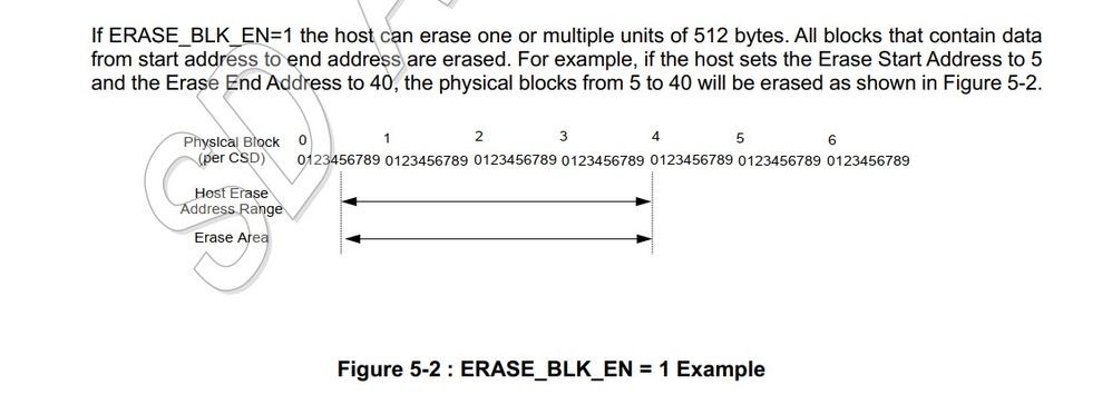

M N
Thank you , And I'm not using FatFs ,At this time I just am using this library nothing else .
And in picture below there is an example of "Physical_Layer_Simplified_Specification"

2- For end erase address it would be like this :
//The Second parameter will replace with 5( as an example we want block number 5 will be our end erase address ) and because of "flag_SDHC = 1" and because of ternary operator "?" resault for second function parameter will be  (5 * 512)*(1) which is block 2560 !!! :
SD_SendCmd(SD_CMD_SD_ERASE_GRP_END, (5*512) * (1), 0xFF, SD_ANSWER_R1_EXPECTED);
But here is the problem it will multiply our EndAddress with 512 ! why should we do this ? why like start address it is not just block number as in last picture sd specification example said (without any multiplication to 512) ?
For CSD v2 in sector_size it has said it is not related to erase operation and AU size has affect on this ? Isn't it related to this 512 ?
