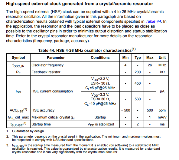

I am trying to choose a
crystal
for the STM32F7. The only problem being is that I cant find a component that respects the recommended values found in the following arm
http://www.st.com/content/ccc/resource/technical/document/application_note/c6/eb/5e/11/e3/69/43/eb/CD00221665.pdf/files/CD00221665.pdf/jcr:content/translations/en.CD00221665.pdf
. Even STM for it's STM32F779I-EVAL board does not respect the gain_margin.
If I have understood correctly there is one main rule governing the choice for a crystal so that the oscillator starts and reaches a stable phase.
gainmargin = gm / gmcrit
gm is the oscillator transconductance specified in the STM32F779 datasheet.
  • Gm_crit_max = 0.001
gmcrit is computed from oscillation-loop passive components parameters.
  • ESR is the equivalent series resistance
  • C0 is the crystal shunt capacitance
  • CL is the crystal nominal load capacitance.
  • F is the crystal nominal oscillation frequency
The one used for the eval board is this one :
https://www.eltech.spb.ru/files/item/NX3225HA-STD-CRT-1.pdf
But I found gainmargin = 1.674730 when it's supposed to be >5
Does anyone know why?

Best answer by STOne-32
Posted on August 17, 2017 at 00:51
Dear all,
Having a crystal compatible with our HSE is very important else there is a risk of no oscillation in worst case conditions.
That NDK crystal is specific for us (STMICROELECTRONICS ) and is not from their public website. Look to the exact reference at the end.
Cl =6.5pF
C0 = 1.3pF
Esr max = 50 Ohm
F=25MHz
Gm margin = 5/0.3 = 16 >>> 5.
Please do not confuse gm _crit and gm_crit_max  there is a factor of 5 between them.
Cheers
Does that have an orderable (full qualified) part number? I'd suppose it is in the BOM, but in case it is a special order part it would be good to know not to use an unsuitable, but higher running, substitute. People are apt to copying a known working design. Can you provide the spec sheet for that part?
