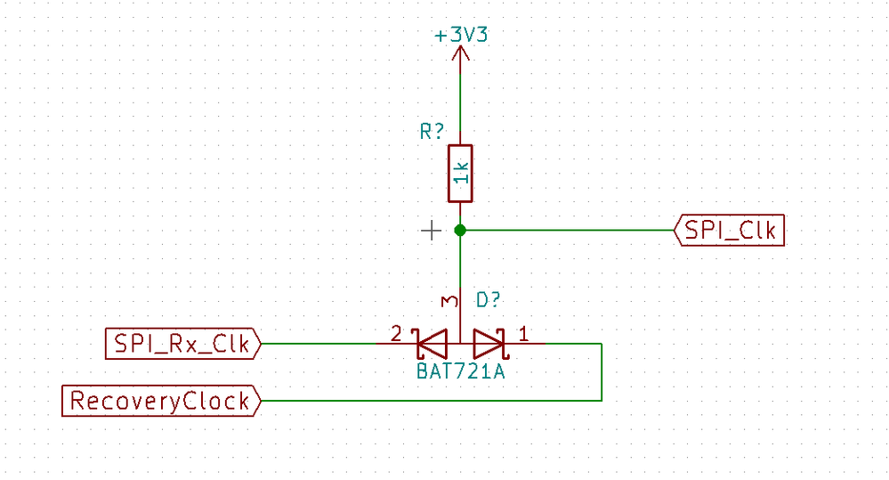

I'm using a STM32F303 micro controller in a noisy environment and there are some spikes on the SPI CLK line which mess up the functionality. The chip is used in slave mode and the SPI messages trigger a state machine. No CS line is employed, the slave is always listening. A spike on the clock line leads to a bitshift and thus false bit patterns or corrupted messages which leave my state machine corrupted. The clock is working at 1 MHz, data word length is 8 bit.
  • Is there a possibility to flush the fifo using a time out on the clock line? E.g. if the 8 clock ticks do not arrive after 10us flush the FIFO and reset the SPI state? I have not found any corresponding commands and deactivating and then again reactivating the SPI peripheral is too slow.
  • And as a more general question: How do I reset the SPI peripheral at all, without a timeout as described above? So how do I flush the FIFO and the registers holding the data? Is there a fast way doing that?

The bus has to be working in a noise environment, I cannot mitigate that. Additionally I know, when the spikes on the clock line happen, so all I need to do (at least that's what I think), is to flush the RCV FIFO or to reset the SPI peripheral after this moment in time.
I call the HAL_SPI_TransmitReceive_IT(&hspi2, (uint8_t *) tx_status, (uint8_t *) rx_status, 1); function after that moment, but the wrong information still gets clocked in. Then I tried just disabling the SPE (SPI enable) bit before this moment and setting it again afterwards: Then the SPI bus does not work any longer. Now I am using HAL_SPI_ABORT (which in my eyes seems to be huge and overloaded procedure) after this spike in order to get a clean, new starting point again - without effect.
Is there no simple procedure to tell the SPI peripheral to start anew, with both FIFOs empty? Going through the whole HAL_SPI_Deinit and then again HAL_SPI_Init(SPI_HandleTypeDef *hspi) cycle is too time consuming.

You could use 2 diodes, if you want the slave to self detect and recover.
