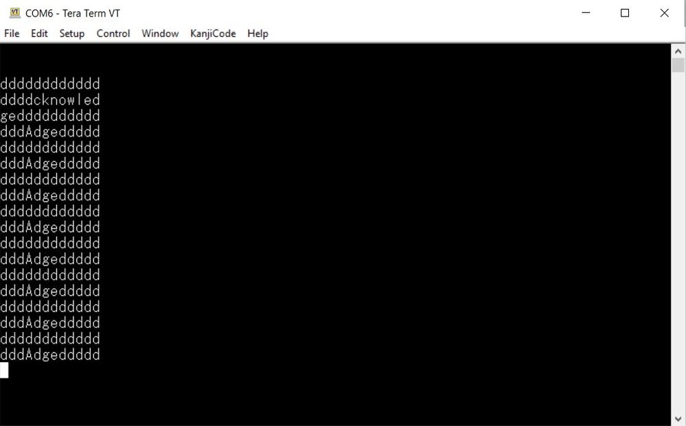

SPI full duplex not working, but MOSI and MISO lines work fine individually. How do I fix this?
KSchr.11
Pardon me for asking repeated questions on SPI, but it's giving me a lot of issues. So far I have configured two STM32 boards as master and slave, and ran code for MOSI and MISO lines individually which seemed to work fine. Now that I combine those codes for full duplex communication, I am getting wrong data.
Assume all functions called work correctly.
Master code :

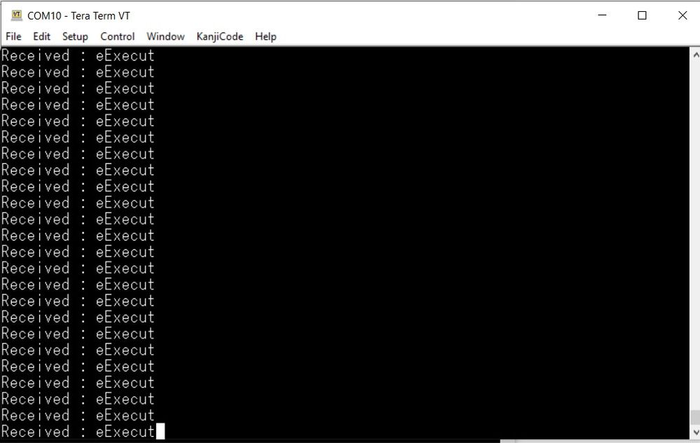

If I run the code on either side of "**************" line individually it works correctly, I get the correct string on PC terminal.
But with the code shown above, this is what I get
On master side:
On slave side:
The slave side seems to be receiving it somewhat correctly, while the master is receiving absolutely wrong message.
What I am doing wrong?

The master side
  • transmits some bytes
  • waits 1 ms
  • receives some bytes
The slave side
  • transmits them to a UART
  • waits 1 ms
Calling uart_txstr() in the slave loop guarantees that the slave is always late to the party, and can't respond in time.
Define correctly.
How long does delayms(1) wait? Hint: if it is dependent in some way on a counter variable which is incremented by a timer interrupt, then it is not exactly 1 ms, but either between 0 ms and 1 ms, or between 1 ms or 2 ms.
What does SPI_write() do? Does "work correctly" imply that it is not only putting a byte into the transmit register when it becomes empty, or there is a free slot in the transmit fifo, or does it actually wait for a byte to appear in the receive data register? What does it check after writing the data register?
What does SPI_read() do? Does "work correctly" imply that it is checking the transition of CS, and flushing the input buffer when necessary?

You aren't operating in true full duplex SPI mode. Data is transferred in both directions at the same time, based on clock edge. The master SPI supplies the clock and begins the transmission. At each edge a bit is clocked from the master TX register into the slave RX register, while the slave TX buffer is clocked into the master RX buffer. This works best with DMA to handle actual data transfers, assuming it's fixed length. Don't think of SPI as a fast UART; it operates in a synchronous mode where both sides set up the data exchange in advance.
This method takes less than half the time to communicate between the two boards compared to your algorithm, and far less CPU time if you use DMA.
Jack Peacock
Well yeah I guess to call it working fine is pretty vague. My SPI_write() and SPI_read are simple functions. They just wait for transmit buffer to get empty, wait if SPI line is BUSY and then write to or read from data register. I'll just edit the post to write the whole code.
I did try using DMA for reception, but it didn't help. Anyway I am trying to do everything without DMA, which I myself don't like, but the professor I am supposed to submit my report to doesn't like the idea of using DMA and wants everything be done manually checking status registers.
It indeed is timing issue as you said. I calculated the approximate time I am losing sending data to PC over UART and it's couple of ms at 9600 bps. So I added small delays before and after sending data from master and now I am getting better data than before. It is shifted by 4 bytes so the order is wrong, but still much better than before. And yes the clock offered by master ain't super accurate, so syncing is pretty difficult. Is DMA is the only way to go about this as another member commented on this post?
