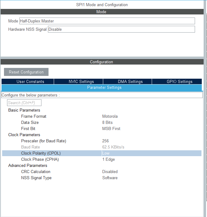

My SPI configuration in CubeMX:

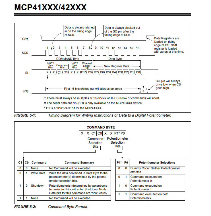

According to the documentation:
I need to send 1 command byte and 1 data byte.

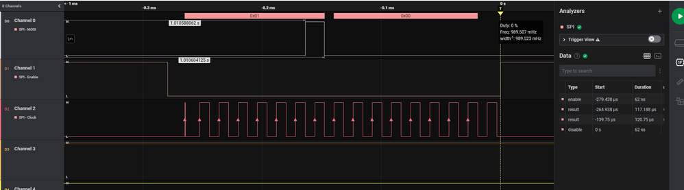

Now in my SALAE software, I see the following:
0693W00000LyaHIQAZ.pngI would like to understand why the first clock cycle is very short. Is that a problem with my logic analyzer or that is normal behaviour?

April 21, 2022
Send a byte with CS high to enable the peripheral (the data will be ignored, but the peripheral will be enabled as a side effect).
The peripheral is not enabled until the first HAL_SPI_Transmit call which means the pins aren't being driven until that point.
uint8_t spi_data1[2] = {0x01,0x00};
HAL_GPIO_WritePin(GPIOF, GPIO_PIN_12, 1); // chip select HIGH
HAL_SPI_Transmit(&hspi1, spi_data1, 2, 0xff);
while (1)
	 HAL_Delay(1000);
	 HAL_GPIO_WritePin(GPIOF, GPIO_PIN_12, 0); // chip select LOW
