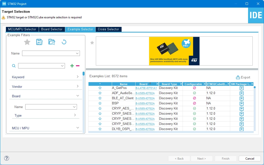

(some) example projects don't use *.ioc file?
  • July 16, 2024
  • 3 replies
  • 2178 views
E.g. the FatFs_USBDisk sample does not have a *.ioc file.
Maybe not all example projects use STM32CubeMX?
(the issue sounds like https://community.st.com/t5/stm32-mcus/creating-stm32cubmx-ioc-project-for-older-stm32cube-firmware/ta-p/49664)
How can I enable the view "Device Configuration Tool" for that example project?
Or: what's the best way to see the Mikrocontroller resources used by that project?
Reason for asking:
I can't add support for serial console (including DMA) to FatFs_USBDisk from a reference project. There seems to be a clashing of using the resources.
Best answer by Andrew Neil
@Andrew Neil wrote:
Correct - they don't all have a .ioc file.
I think the 'Configurable' column tells you which is which:
AndrewNeil_1-1721148616417.pngfor the ones which do have a .ioc file;
AndrewNeil_2-1721148655038.pngfor the ones which don't.
PS:
This, of course, doesn't stop you from re-configuring the project - it just means that you have to do it directly in code, rather than though the CubeMX GUI.
In most cases, the so-called non-configurable (sic) ones will have a Board Support Package (BSP) to abstract the hardware details and, thus, facilitate re-configuration.
Some just have C initialisation code for the clocks, peripherals, etc - see here.
You can't.
Just have to browse the code to see what's used.
If the example in question is for an ST board, then MXCube should have awareness of that board ...

Tesla DeLorean
Guru
July 16, 2024
Yes, some of the examples were actually coded by engineers familiar with the job, and not pressing buttons.
CubeMX generates code from templates and boiler-plate, and whilst it uses HAL, its not the type of HAL or SPL code we typically write.
With the Non-IOC methods, it's perhaps better to sand-box your CubeMX/IDE stuff into it own project, and then pull/merge the salient code, for initialization and interaction, into the more generic HAL implementation.
The Reference Manual then becomes your resource to know what peripherals work/conflict with each other, and how to make choices from the tables of routing/interconnectivity the IC facilitates, and the Data Sheet is the resource with respect to the pins and alternate function mappings there.
