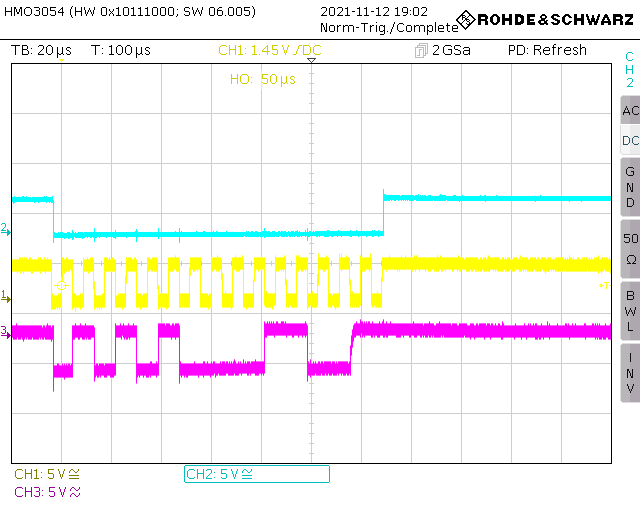

This reading is done every 10 seconds, and works properly for a few hours.
The following screenshot shows the corresponding SPI traffic.

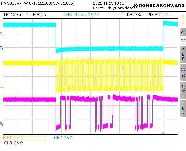

0693W00000GXmImQAL.pngBut after a few hours, instead of the normal SPI 16-bits frame seen above, a 87-bit frame is sent and wrecks havoc in the TC77 configuration (for which the first 16 bits of the clock are a read and the next 16 bits are a write to the config register).
After that broken frame, the polling continues normally (but now the TC77 has been shutdown by the spurious command, in that mode it returns the manufacturer ID instead of the temperature).
The following screenshot shows that unexpected long frame.
This looks like a marginal issue, because it happens for one variant of the firmware, but not on another one using exactly the same read function. It also appears to be hardware dependent, as it happens consistently after a few hours on several boards, while others are running for 1+ month without issue.
Can someone help me with this/point me in a direction to investigate further?
> SPI_Direction_1Line_Rx
In master, one line receive only mode (BIDIMODE=0 and RXONLY=1), the clock is sent out continuously.
Because of this, if an interrupt happens while CS is low, the clock will continue to tick away until it returns and you disable the peripheral.
The solution is to use 2-line mode with the MOSI pin uninitialized. (Or disable interrupts during the critical section of code.)
PA:99
Thank you a lot for your clear and amazingly fast answer!
