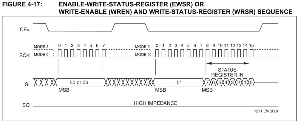

CE#(NSS) must be driven low before the EWSR (enable write status register) instruction is entered and must be driven high before the EWSR instruction is executed.
CE#(NSS) must be driven low before the command sequence of the WRSR (write status register) instruction is entered and driven high before the WRSR instruction is executed.

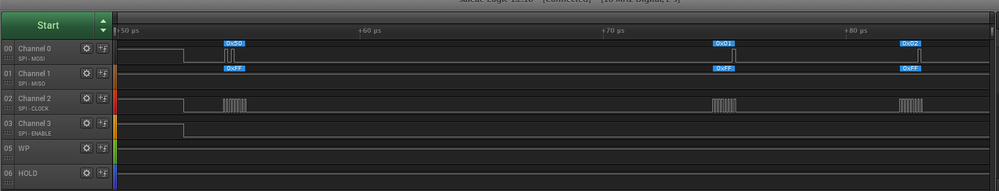

But looking at the digital levels with a logic analizer this is what the result is:
As you can see, SPI-ENABLE(NSS) is driven low before the start of the first byte (0x50) and then stays that way for the rest of the communication, making the EWSR command invalid.
I'll appreciate any comments, thanks.

So, I kinda find something to keep going..
The STM32CubeMx intialize the "hspi1.Init.NSS" as "SPI_NSS_HARD_OUTPUT" wich makes the NSS pin be driven by the firmware in it's self. And this made the HAL_GPIO_WritePin command not work.
So I ended up changing a few configurations:
First I change the configuration of the pin itself to be GPIO_MODE_OUTPUT_PP instead of GPIO_MODE_AF_PP.
__HAL_RCC_SPI1_CLK_ENABLE();
 __HAL_RCC_GPIOA_CLK_ENABLE();
 /**SPI1 GPIO Configuration
 PA5 ------> SPI1_SCK
 PA6 ------> SPI1_MISO
 PA4 ------> SPI1_NSS
 PA7 ------> SPI1_MOSI
 GPIO_InitStruct.Pin = GPIO_PIN_5|GPIO_PIN_6|GPIO_PIN_7;
 GPIO_InitStruct.Speed = GPIO_SPEED_FREQ_VERY_HIGH;
 GPIO_InitStruct.Alternate = GPIO_AF0_SPI1;
 HAL_GPIO_Init(GPIOA, &GPIO_InitStruct);
		// PA4 control
		GPIO_InitStruct.Pin = GPIO_PIN_4;
Then changed "hspi1.Init.NSS" from "SPI_NSS_HARD_OUTPUT" to:
hspi1.Init.NSS = SPI_NSS_SOFT;
This made the signals change whenever the HAL_GPIO_WritePin was called. It also made the logic analyzer not read the SPI signals properly, but thats just bad for the logic analyzer.
