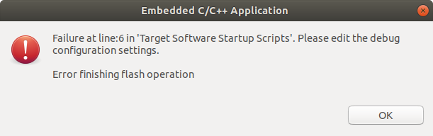

I encounded an issue using TrueStudio in debug.
I work until 6 weeks on a card with an stm32l431 on it and it works fine.
I'm on windows 10.
But today, my collegue try something on this card and now it's impossible to load a file in debug.
My collegue is on Linux.
Are using an ST link prob. We already have the same settings on each compter (windows and linux).
But now, most of the time, that's impossible to load and debug a program using TrueStudio (on both computer). But sometime, we can load and debug for only one time.
But using CubeProgrammer it's works fine (every time).
The TrueStudio logs:

Is I try to load the program using TrueStudio, when I have the failure just after I launch CubeProgrammer and I see that nothing was loaded on the board!

In attachment you can see a screenshot of the TrueStudio error message.0690X000008ibsnQAA.png

Solved, it only was a cuted wire on st prob.
2 REPLIES 2
AJouv
But if we comment the "load" in the Startup Script, its already works all the time.
But in that case we need to load ouor .elf file using CubeProgrammer and than debug using TrueStudio !
Not realy comfortable to work
AJouv
