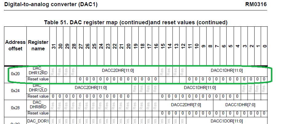

    The two-channels used by the original example write a 32-bit value to a 32-bit register that describes two 16-bit samples written to the left/right (1/2) channels simultaneously. In much the way stereo sample would be found in a .WAV, and how the hardware pairs them together in this common register. The architecture is described in the reference manual.
    This enables a single DMA operation, on a single DMA channel, to write both channels synchronously. Other methods using two DMA channels could be used, but this wastes both bandwidth and resources.

    #define DAC_DHR12RD_ADDRESS (DAC_BASE + 0x20) // Right Align 12-bit Dual
    Not +0x28, which is two 8-bit channels in the low order word.

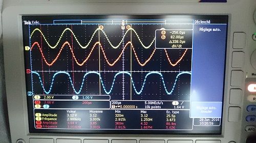

    After several attempts, the best I could have is circa 3kHz. When I go higher it becomes weird (4kHz results in 4.5kHz, and 4.5kHz and higher just stuck at 5.1kHz).
    So maybe these are two very different problems, but I thought maybe there could be a connection.
    So I'm not sure how to achieve this amount of samples with this frequency height.
    Also, you are right about the DHR address, so I changed it, but now, instead of having just noise, I have a triangular waveform, I don't know what I did. I changed nothing but the DHR address.
    EDIT: The triangle's amplitude is more or less 120 mV and a frequency alternatively of 1.4kHz and 2.5kHz (more or less).

    I don't have any F334 boards, this works on a STM32F3-DISCO, providing 3 KHz 3 Vpp Sine waves on PA4 and PA5

    Hi Clive.
    I just ran your code, and I must tell you that, in a very platonic way, I love you.
    It works.
    So: Thank you, very, very much.
    I just still have a couple of questions to be sure I can manipulate it on my own:
    - I used it with timer 2 at first, then timer 6 (although it is expressed that the typedef doesn't fit for timer 6), and I don't see any difference. Is there actually any, (if not, what is the point)? Or is it just because my program is at this moment too simple to impact the choice of the timer?
    - Why do I need the PA.05 (DAC1_OUT2) since it seems that I have a good sinewave on PA.04? The waveform I have on channel 2 is not a sine, it's... I don't really know. I took a picture of the oscilloscope to show it to you.
    - What I understood at first was that the sine waveform (the values from the table) was separated between the two channels. Looking at the signal on channel 1, I seem to misunderstand. I only have something on channel 2 when I enable the buffer. Flatline when it's disabled. Can you explain (briefly) how does it work?
    - I see the importance of that line:
    SYSCFG_DMAChannelRemapConfig(SYSCFG_DMARemap_TIM6DAC1, ENABLE);
    because I pretty much have flatline/noise when I comment it, but I don't get why does it work? When I talk about timer 2 everywhere else in the code (init, config and all) except here, it still does work. Also, the comment of the function says it's for remapping from DMA2 to DMA1, but I'm almost sure there is no DMA2 on F334 (I saw no mention of it anywhere). How is it possible?
    Thank you again, I know this is a lot of questions, but I can feel I'm almost there!

    The original example seeks to demonstrate the output of two sine waves a) to provide an example of left/right audio channels, and b) the binding of the DACs using a single DMA, single register, and pacing the sample rate with a timer. The two waveforms are phase shifted to permit observation/validation on a scope. The 90 degree shift equates to sine/cosine type output. I tend to favour clear and concise examples that hit the target with a high degree of accuracy.
    This could easily be retasked to doing just a single channel.
    I'm going to assume you have a
    http://www.st.com/content/st_com/en/products/evaluation-tools/product-evaluation-tools/mcu-eval-tools/stm32-mcu-eval-tools/stm32-mcu-nucleo/nucleo-f334r8.html
    , in this case PA5 is connected to an LED, and this will present significant load to a DAC output. The DISCO board I'm testing doesn't have anything other than scope probes attached.
    http://www.st.com/content/ccc/resource/technical/document/user_manual/98/2e/fa/4b/e0/82/43/b7/DM00105823.pdf/files/DM00105823.pdf/jcr:content/translations/en.DM00105823.pdf
