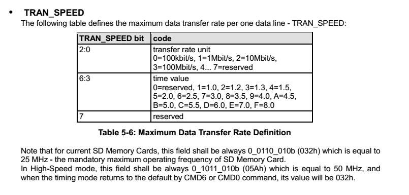

    I got value of 50 for
    sprintf(card_info,''%.2d'',cardinfo->SD_csd.MaxBusClkFrec);
    printf(''Card info: '');printf(card_info);printf(''\n'');
    result :
    Card info: 50
    is it 50MHz maximum for MaxBusClkFreq on this SDcard ?

    francescatodiego
    April 21, 2014
    Posted on April 21, 2014 at 09:38
    From SD docs Physical Layer Simplified Specification Version 4.10 pag. 116

    50 dec = 0x32 hex, so 25 MHz
    From 72 MHz a divisor of 3 would get you to 24 MHz, which would be a setting of 1 for SDIO_TRANSFER_CLK_DIV.
    A more practical approach to validating an SDIO interface would be to CRC32 or hash file data and confirming that matches on a PC and STM32 platform, and that it works repeatedly.
