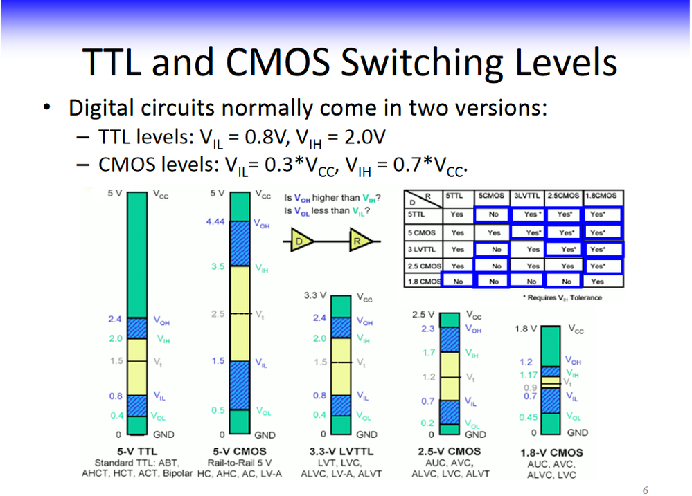

MAybe logic levels should be taken into account when connecting uart to external circuitry (level shifter might be needed):
Posted on March 03, 2018 at 22:43
Forgot to add a link:
http://homepage.cem.itesm.mx/carbajal/Microcontrollers/SLIDES/GPIO_Applications.pdf

It seems that connecting the Micro's UART (@1.8v ) to an external TTL UART (@3.3) will not work.
I am going to use 1.8-to-3.3 level shifter.
