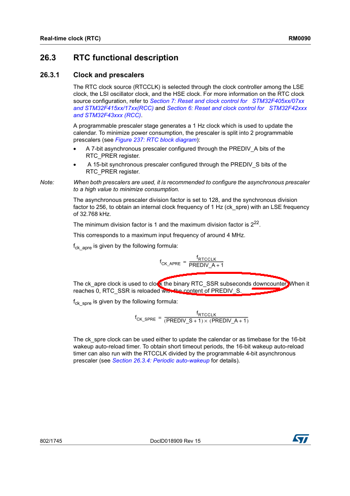

Following is GetTime function, It always give SubSeconds from 255 to 0 in count down mode. Values read in few ms interval.
static void RTC_GetTime(void)
RTC_DateTypeDef sdatestructureget;
RTC_TimeTypeDef stimestructureget;
HAL_RTC_GetTime(&hrtc, &stimestructureget, RTC_FORMAT_BIN);
HAL_RTC_GetDate(&hrtc, &sdatestructureget, RTC_FORMAT_BIN);
printf('\r\n%0.2d:%0.2d:%0.2d:%0.2d', stimestructureget.Hours, stimestructureget.Minutes, stimestructureget.Seconds, stimestructureget.SubSeconds);

uint32_t SubSeconds; /*!< Specifies the RTC_SSR RTC Sub Second register content. This parameter corresponds to a time unit range between [0-1] Secondwith [1 Sec / SecondFraction +1] granularity */
SecondFraction = 255
granularity =
1 Sec / (255 + 1) = 0.00390625
SubSeconds = 212 read value
real value in sub second  =
SubSeconds *
granularity = 0.828125 sec = 828 ms
So output values are correct only in reverse order, why its in reverse order its problem ?
