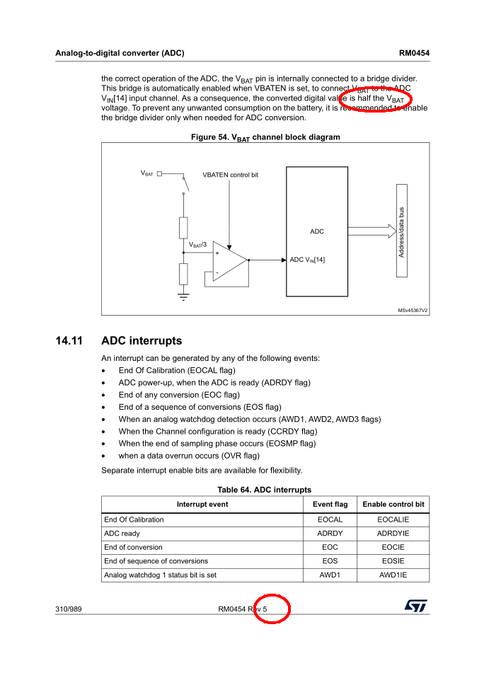

Dear ST Team, could you please update this section with correct information?
There is incorrect text description or figure in RM0454 Rev 2 in section 14.10 (VBAT).
Text: "...converted digital value is half the VBATvoltage."
Figure: VBAT/3.

waclawek.jan
May 15, 2022
Hi Imen,
0693W00000NpyeeQAB.pngAnd the same is in RM0444 rev5.
@Imen DAHMEN​
May 17, 2022
Thank you @Community member​ for bringing this to my attention.
I'll make sure to correct this in the coming revision.
Thanks
Imen
waclawek.jan
May 17, 2022
Thanks, Imen!
