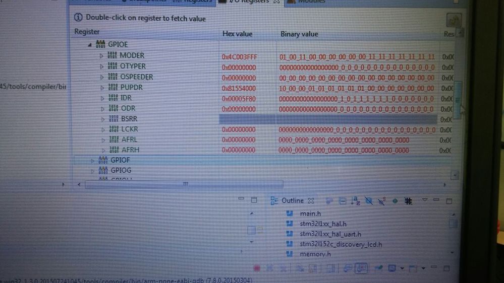

Hi ST support,
I have made a custom PCB using stm32L152v8t6 , there are four copies and I have flashed same code in all four boards. There are 6 gpio input pins which are initially pulled up.So after keeping the device on for some time the voltage across some gpio pins drop down. If I keep the device off for some time or reheat the faulty pins it starts working. Why am I facing such a weird issue ?We are moving on to production and want to solve this issue as soon as possible.The problem is observed in two boards while other two are working.

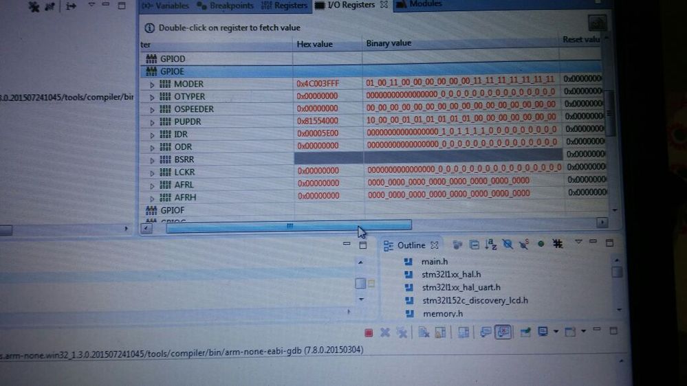

-Just want to add on this point , the low power mode(stop mode) is enabled after 3mins of inactivity. Before going to low power mode (stop mode), all the pins are configured as analog input pins except one pin being configured as interrrupt to exit low power mode. On wakeup 6 pins are again reinitialized to input pullup
How the voltage shifts?
-Suddenly
To which voltage?
-varies between 1.23V to 0.82V
If it is possible to run the debugger, stop the code when anomany occurs and inspect the GPIO register settings
-Attaching the gpio register values for both working and non working conditions
Working fine:
Fault occured:
