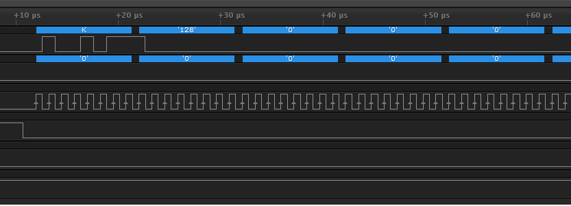

I ran the code below, and looked at the logic analyzer (figure also below). Most immediately, my instruction 0x4B seems to be coming out of IO1, aka PB1 -- not IO0, aka PB2 as I would have thought. I switched up and connected my IO1 to the IO0 (which is the input) on the flash part, same result. But this is odd. If this is a configuration issue, what would that be? If this is impossible, I will re-check my wiring for the fourth time.
Secondly, I see that my correct bytes b01001011=0x4B are being sent out, but weirdly the line stays high for an additional clock cycle, which is recognized by the analyzer as a '128' in the next byte, which is supposed to be a dummy byte. I don't know why this is, or if this is indicative of a problem, or if the parts simply don't care because its a dummy byte.
Third, my part isn't responding. The logic analyzer looks just like the FLASH part spec, but I have not ever received anything from the MISO yet, flatlined. This is before and after trying to switch up my MISO and MOSI, per my IO1 confusion above.

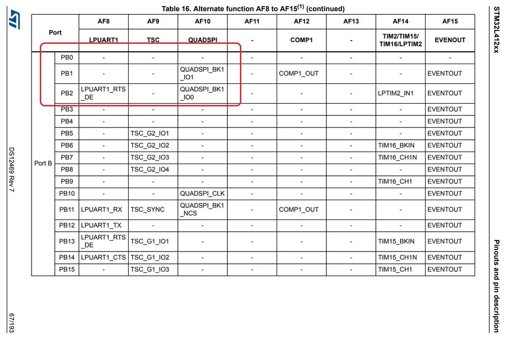

PB2 is uninvolved, PB1 is BK1_IO0, and PB0 is BK1_IO1, see the pin lists, not the AF table
The table of page 67 is wrong
https://www.st.com/resource/en/datasheet/stm32l412rb.pdf
@Amel NASRI​ @Imen DAHMEN​ This QUADSPI column is off-by-one
COMP1_OUT should be on PB0
LPUART1_RTS_NE and LPTIM2_IN should be on PB1
LPTIM1_OUT on PB2
PB4 is wrong, PB5 is wrong
PB10/PB11 for QUADSPI looks correct
Whole table on this page needs a thorough review and validation

Oh my gosh clive, thanks so much. That worked. How did you discover this mistake, just superhuman attention to detail?
Merry christmas!
Merry Christmas
The pin assignment looked odd, based on other STM32, so I cross checked the list vs table.​
