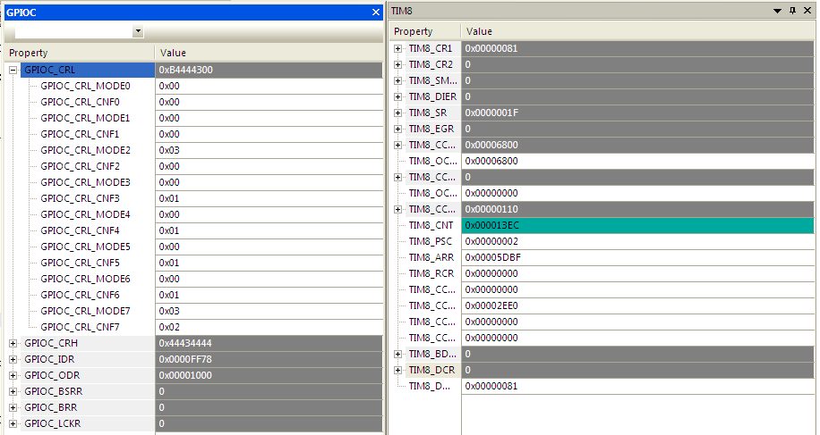

    It looks like the counter and the reloading is working just great from the Keil uVision tools.  However, it looks like TIM8_CH2 is not connected to the actual pin (PC7).
    How could I trace if the pin (PC7) is getting connected to TIM8_CH2.  I can see that if I use PC7 as standard GPIO output pin I can toggle it easily.   For some reason the mapping that connects TIM8_CH2 to PC7 is missing.  I don't see anything obvious, but it might seem to be something in AFIO.  I have already enabled the AFIO clock.
    The register values are the following:
    kzawada
    kzawadaAuthor
    May 17, 2011
    Posted on May 17, 2011 at 14:14
    Needed to add the following line to connect TIM8_CH2 to PC7:
    TIM_CtrlPWMOutputs(TIM8, ENABLE);
