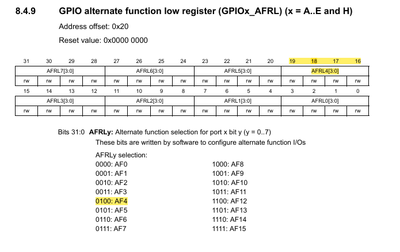

I've wrote a code without using Hal to produce a signal on the scope but i'm not getting any signal on my pin.
This is on a NUCLEO F401RE. Using TIMER3_CHANNEL1 and GPIOB for my Alternate function.

    > GPIOB->AFR[0]|= (1U<<18);
    This sets AFR for PB4 to 0b0100 = 4, that's not what you want.

    This is a reference of the datasheet. The reset values are 0's hence, I am trying to SET pin 18 and leave the rest to 0 as highlighted. Not sure what  you meant by saying that's not what I want ? Any further explanation would be helpful . Thanks

    Is the goal to write the most inefficient code, that's hard to maintain too?
    TIM3_CH1 is AF2 on PB4
    ARR and PSC are set as N-1 values

    I've made changes and took on your advice , wasn't getting a signal still when I run it . I know when using CUBE/HAL you need to set the clock config tree, and as I'm writing manually I don't have anything set for it ,could that be the issue?

    You should have some output without configuring the clocks in RCC, too, as the whole mcu runs out of the default HSI RC oscillator at 16MHz.
    Read out and check/post content of TIM and relevant GPIO registers.

    TIM3->CCER = TIM_CCER_CC1E;
    Use bit names instead of magic numbers!
    Also, timer clock frequency is 84 MHz (2 x ABP1 frequency).
