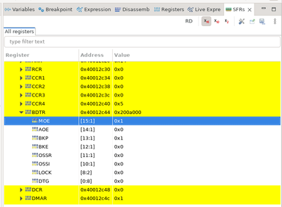

I don't use Cube but TIM1 is an Advanced Timer and needs TIMx_BDTR.MOE to be set.

As far as I understand the MOE is set with the PWM project.
waclawek.jan
March 21, 2024
Show all Timer and relevant GPIO registers content.
