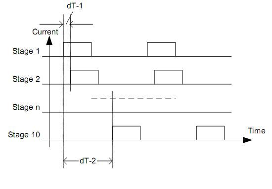

You can change  this value (TIM_OCInitStructure.TIM_Pulse = CCR_i) on different channels. This defines duty cycle i.e ON time
subbaraon
Posted on May 17, 2011 at 13:47
Thanx for ur response.
That's fine and I did.
But, my requirement is delay between the ON TIME pulses of PWM waveforms with same duty cycle.
Observe the attached picture for requiement.
