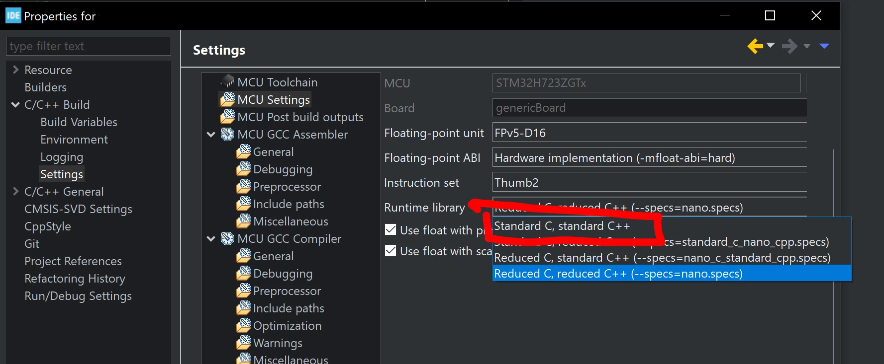

What is the best way to use sscanf with uint8_t?
When I use:
 uint8_t x ;
 char* y = "23" ;
 sscanf ( y , "%hhu" , &x ) ;
I stuck at:
void HardFault_Handler(void)
I found following workaround that works:
 uint16_t x1 ;
 uint8_t x2 ;
 const char* y = "23" ;
 sscanf ( y , "%hu" , &x1 ) ;
 x2 = (uint8_t) x1 ;
but it doesn't look best. So what is the right way of processing uint8_t in above case?
V/r
yabool2001
Best answer by TDK
Then it's not implemented in the library you're using (nano).
You can link to the standard C++ library and it's likely in there.

TDKBest answer
October 29, 2023
Pavel A.
October 29, 2023
This looks like limitation of newlib-nano (no ll and no hh). Your workaround is perfect.
