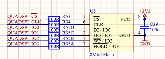

Hello together! :)
I am trying to read the status register 1 of the QSPI Flash W25Q80DV via QSPI. Unfortunately I don't get any data in the buffer. I only get 0x00. The topic of QSPI is still very new to me, so I may have overlooked something obvious here...
Here is the important part of the main code:
  * PE7: IO0 = DI
  * PE8: IO1 = DO
  * PC11: CS
  * PB2: CLK
 uint8_t txBuffer[3] = {0};
 uint8_t rxBuffer[10] = {0};
 txBuffer[0] = 0x05; //Read Status Register-01
 HAL_GPIO_WritePin(GPIOC, GPIO_PIN_11, 0); //Drive the CS low
 HAL_QSPI_Transmit(&hqspi, txBuffer, 100);//INstructioncode 0x05 for status register 1 shifting to DI pin
 HAL_QSPI_Receive(&hqspi, rxBuffer, 100);
 HAL_GPIO_WritePin(GPIOC, GPIO_PIN_11, 1);

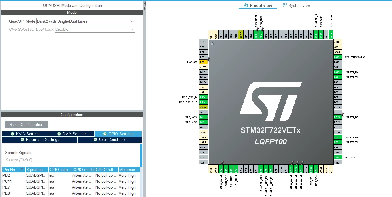

DStan.8
DStan.8Author
August 1, 2022
@Community member​ thanks for your help! I have now set the PIN as GPIO output and adopted your function and set the prescaler to 1.
Unfortunately, it still doesn't work and I am at a loss here. Here are excerpts from the initialisations and the while-loop...

Tesla DeLorean
Guru
August 1, 2022
Look, they aren't manually controlled GPIO pins, they should be AF (ALTERNATE FUNCTION) pins controlled by the PERIPHERAL
The PERIPHERAL drives and controls the NCS, CLK, D0 and D1 pins
For CubeMX, likely hidden in the MSP code, so you'll need to dig for that.
Or your implementation in hardware simply doesn't work properly.
The subroutine I showed controls the entire transaction. You don't fiddle with the CS pin, or do the Transmit/Receive outside of the context of a command. You could perhaps, but it would require a lot better understanding of the implementation.

DStan.8
DStan.8Author
August 2, 2022
Thank you for the answer. I will take a closer look at the examples. I now have the following configuration:
