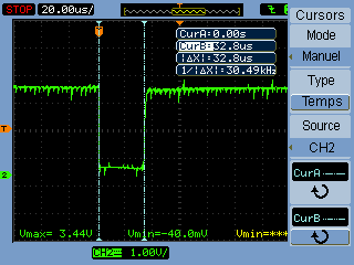

2017-03-24 7:51 AM
Find below, the pin state when I execute NVIC_SystemReset()
The reset pin is tied to 0V during 33µs.
2017-03-24 8:29 AM
Make sure you have nothing driving it high (push-pull) externally.
Review the pin state with a scope when you use NVIC_SystemReset()
