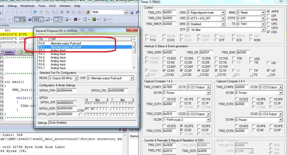

I recently migrated to STM32 Platform and I'm trying to learn all the Peripheral features without using Standard Peripheral Libraries.
Problem Statement:
I am not able to  get PWM output on  timer output channel 2 ( GPIOA1)  after configuring general purpose timer 2 of STM32F103c8T6 Micro-controller in PWM mode 2.
My Configuration:
Timer :              General Purpose timer 2
Timer Clock:     72 MHz
Duty cycle:        50%
Frequency:       50 Hz
MCU crystal :   8 MHz
I configured the GPIOA in Alternate function output Push Pull mode with maximum frequency not exceeding 50 MHz,  I connected an LED bulb to the GPIOA pin 1, but the LED wend on glowing without reduction in the brightness level. The LED was still glowing even after i performed a test with duty cycle set to 0. On the debugger window I could see exactly all the parameters I configured and the Count register was getting incremented. I cannot find information regarding selection of alternate functions for a GPIO Port.
I used  Keil Micro vision 4 IDE for compiling and debugging my source code,
I read reference manual for register description and used steps from AN4013 Application note to develop source code
Kindly have a view of my source code and please notify me the corrections that need to be done. The target specifications are mentioned in the source code.

    Hi
    Menon.Rakesh
    Please refer to GPIO chapter in RM0008 and product datasheet.
    In your code, it seems you are configuring pins 0 and 1 of port A instead of pins 1 and 2 as per your comment in the code (but I don't think this is the problem as PA1 is properly configured).

    Hello Amel,
    I  configured the port pin to be gpio: 'alternate function output push-pull ' after reading RM0008, I doubt whether if there is an option to select which alternate function have to be assigned for specific pin, under gpio section. I read about pin remapping but that's not what I really need.
    Any how I will also test the ready to use examples which you mentioned.

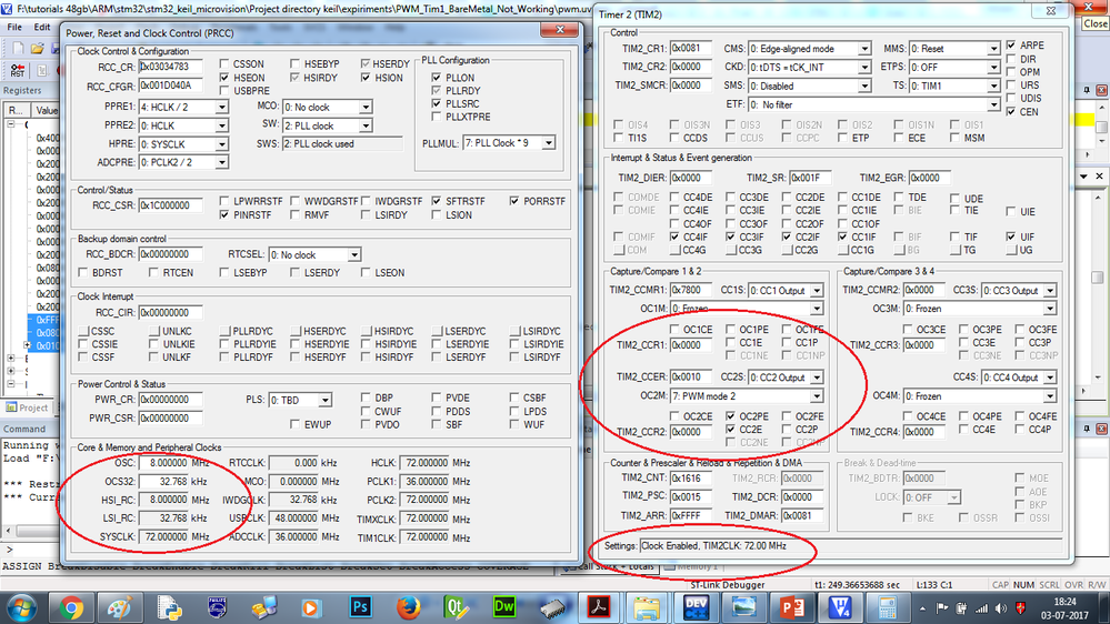

    Hello Mike,
    Also when you put the pulse to zero the pin goes to a high state and don't know if you have the LED configured active low or high.
    I configured the LED  in active  high configuration.
    What I don't see in your code is the configuration of the MCU clock.
    If you are mentioning about system core clock, it has already been set to 72 MHz inside the header file ''stm32f10x.h ''
    The timer clock is also 72 MHz only because the clock branching to timer 2 from APB1 has a multiplier.
    I could see that in the debug Window.
    Also here is the view of the GPIOA peripheral block:
    I couldn't find any clock setting mistakes.
