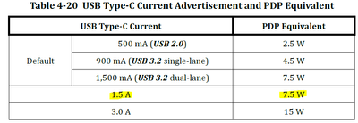

You are looking for basic Type-C SINK with 1.5A max without Power Delivery (STM32U0 series).
Legacy current on USB-C VBUS is 5V 0.5A when VBUS turns-on.
The system must be able to start below this current threshold.

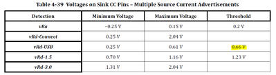

Once started, system senses SOURCE capability (0.5A or 1.5A or 3.0A).
It is done thanks to voltage on active CC line (>0.66V on 5.1kΩ)
Inrush current is managed by MOSFET turn-ON time and maximum capacitor on VBUS line 10µF.
