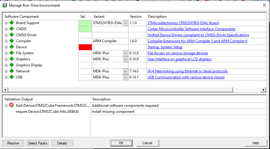

Also looking at the RTE configuration do you know why I get the RED block when I enable serial wire debug. For

Do you have a STM32H7B3i-EVAL board or a STM32H7B3i-DK (DISCO) board? It looks like you selected the EVAL board for the Board Support which will not work if you have a '-DK'.
onio
onioAuthor
August 17, 2020
Yes I am using STM32H7B3i-DK (DISCO) . I would change that and report back.

I have sorted out my issues for now as I am now able to run a simple Blinky program without any issues with debugger or connections. I solved by turning off all the User Configuration flags which enables security feature on the chip using STMCubeProgrammer and also ensured that the correct External Loader is selected as I found out with the help of @JMors.1​  that this option is not selected by default which is correct.
As I understand it, the flags that I turned off were responsible for controlling the Independent Watchdog which initiate an erase of the flash if no kicked before it expires. Just for completeness the flags are also responsible for other things such as voltage monitoring etc.
For my simple test program I don't need to have this feature turn on as I am working with debugger which would require start/stopping code etc.
