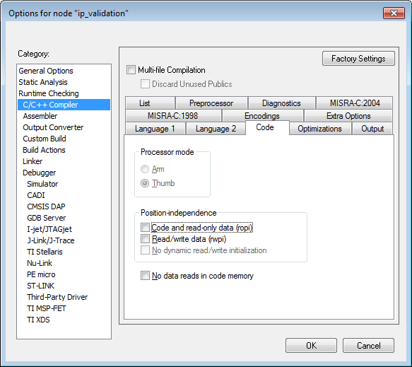

how i can configure my project to make a relocatable application , i use the IAR workbench.
  1. i activated the --ROPI option in IAR Options
  2. i modified the .s file as follow :
MODULE ?cstartup
 ;; Forward declaration of sections.
 SECTION CSTACK:DATA:NOROOT(3)
 SECTION .intvec:CODE:NOROOT(2)
 EXTERN PI_Reset_Handler
 PUBLIC __vector_table
 PUBWEAK Reset_Handler
 SECTION .text:CODE:NOROOT:REORDER(2)
Reset_Handler
 LDR R0, =PI_Reset_Handler
 BX R0
  1. i modified in main.c
/* Private functions ---------------------------------------------------------*/
extern void __iar_data_init3(void);
extern void __iar_program_start(void);
void PI_Reset_Handler(void)
 SystemInit();
 __iar_data_init3();
 __iar_program_start();
 * @brief Main program
 * @param None
 * @retval None
int main(void)
But when i put the binary file of app in flash at address (0x8010000) , my boot when jump to app , the app can't run . i remarked that the NVIC must be relocated . but the problem when i relocated the NVIC ( add an offset x10000) , i see the same problem .
So how i can configure my app to be relocatable please ?

David SIORPAES
March 28, 2019
Options / C/C++ Compiler / Code / Position-independence
helmi haddad
March 28, 2019
I already activated this option , i still have the problem how the IVECT table be relocatable ?
