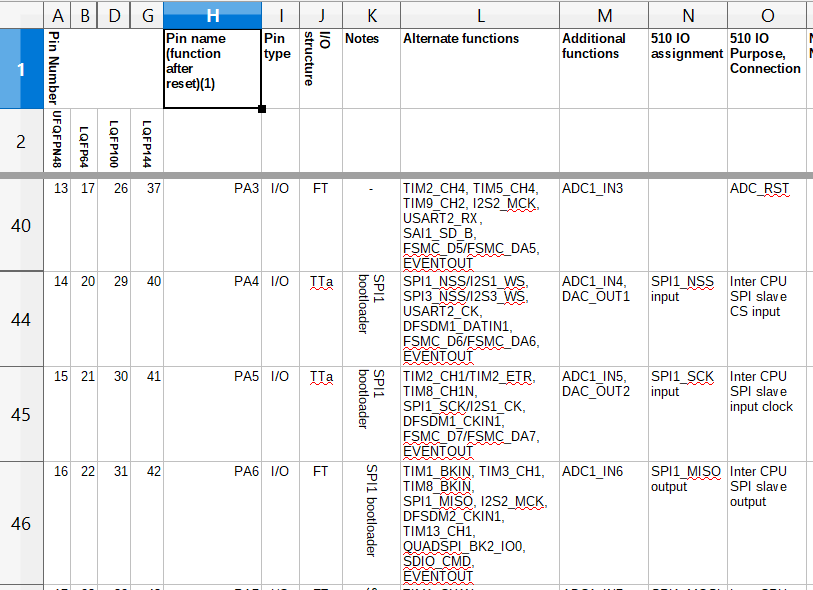

Does ST provide an excel or CSV form of a pin functionality spreadsheet, to aid in assigning pin connections during development? This would be similar to Table 13 in the datasheet, but not in PDF form.

@Stan0402​ - If only ST would provide data in spreadsheet form, it would help us a lot!
Here's what I do:
  1. use the Tabula utility to extract the table from the datasheet PDF into CSV
  2. fix up the headers in CSV with an editor
  3. import CSV into a spreadsheet.
  4. hide rows pertaining to pins not present in the package we're using
  5. change background to red for all resreved pins (power, swd, crystal, etc)
Its very annoying!
Hope that helps,
Best Regards, Dave

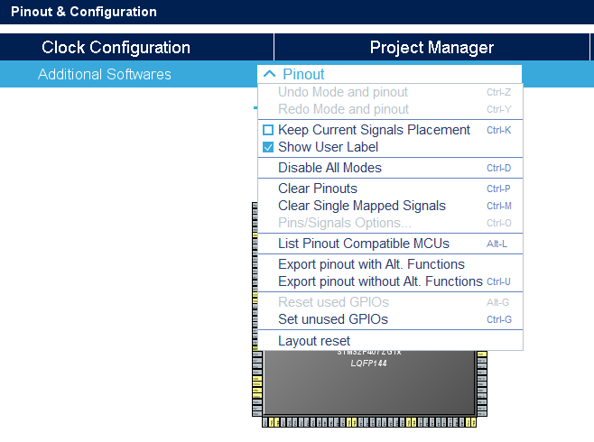

Using STM32CubeMX, you should be able to export the pinout to a csv file:

Thanks @Amel NASRI​ but that is not quite what we need. Especially when trying to determine which package to use, we need something more like the table in the datasheets. Also when trying to prototype with a large package (for example on Nucleo) for a product that will use a smaller package, we need all variants in one sheet. Example below,
