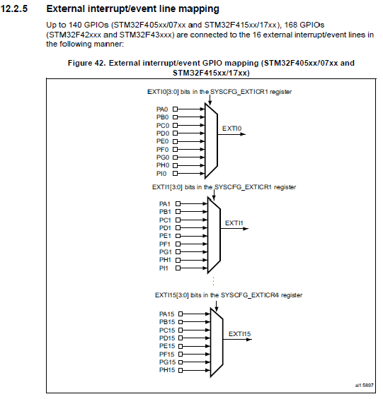

Is it possible to link same pin number of different GPIO ports on the same EXTI line ?
For example, create an interrupt on line_0 for the GPIO pin A0 and the pin B0. It seems impossible to achieve with the ST librairies - but I don't understand why it's impossible regarding to the internal schematic of the STM32F4... I really want to use more than 16 GPIO with interrupts. Is there a software way to perform this interruption ?

    NO, it uses an N-to-1 mux, only one bank's pin reaches the signal conditioning.

    Generally you'd use an external priority decoder to decimate the number of pins required on the CPU.
    Alternatively you could use TIMx_CHx pins in input capture mode, or poll slow GPIO sources. I'd recommend a print out of the Data Sheet with pin designations, and a high-lighter pen. Assign the TIM pins first, then the EXTI. Draw a pin vs bank matrix if that helps.

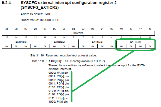

    Also note on the STM32F4 family (STM32F405/407xx and STM32F415/417xx) this erratum -
    Configuration of PH10 and PI10 as external interrupts is erroneous
    Description
    PH10 or PI10 is selected as the source for the EXTI10 external interrupt by setting bits
    EXTI10[3:0] of SYSCFG_EXTICR3 register to 0x0111 or 0x1000, respectively. However,
    this erroneous operation enables PH2 and PI2 as external interrupt inputs.
    As a result, it is not possible to use PH10/PI10 as interrupt sources if PH2/PI2 are not
    selected as the interrupt source, as well. This means that bits EXTI10[3:0] of
    SYSCFG_EXTICR3 register and bits EXTI2[3:0] of SYSCFG_EXTICR1 should be
    programmed to the same value:
    • 0x0111 to select PH10/PH2
    • 0x1000 to select PI10/PI2
    Workaround
    None.
