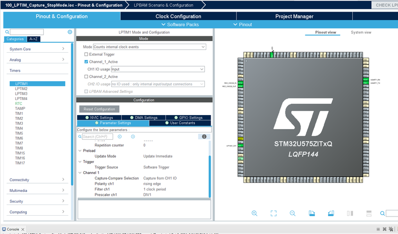

For the Nucleo-575ZI-Q, while in stop mode 2, I have the capture module enabled, I set CH1 IO Usage as input.
A square wave generator connected to PC1->LPTIM_CH1.
While the Micro is in stop mode 2 an indeterminate number of pulses trigger successive captures.
If the pulses on PC1 were odd CCR1 has the correct data.
If the pulses on PC1 were even CCR1 value doesn't updated at all.
Please note that all pulses arrive while STM32U575 is on stop mode.

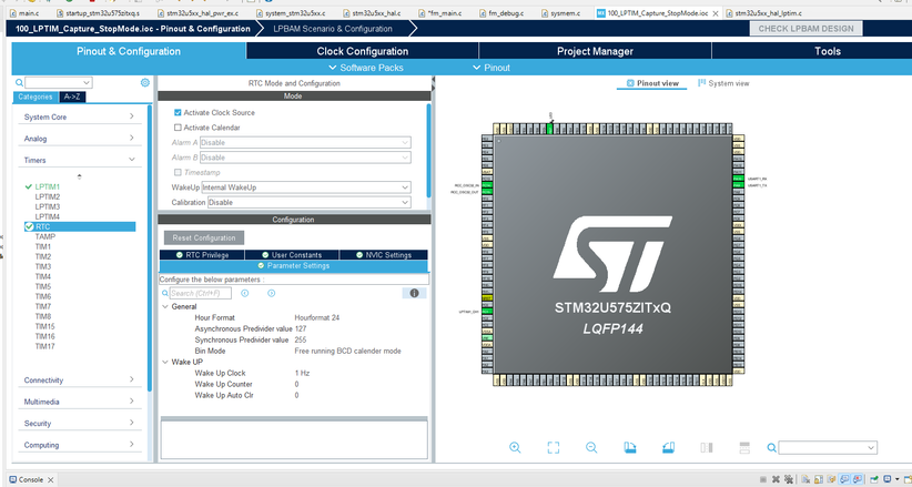

I made a very short project isolating the problem, the RTC is used to exit stop mode 2 every second, when waking up only CRR1 is read and returns to stop mode 2.

static void MX_LPTIM1_Init(void)
  /* USER CODE BEGIN LPTIM1_Init 0 */
  /* USER CODE END LPTIM1_Init 0 */
  LPTIM_IC_ConfigTypeDef sConfig = {0};
  /* USER CODE BEGIN LPTIM1_Init 1 */
  /* USER CODE END LPTIM1_Init 1 */
  hlptim1.Instance = LPTIM1;
  hlptim1.Init.Clock.Source = LPTIM_CLOCKSOURCE_APBCLOCK_LPOSC;
  hlptim1.Init.Clock.Prescaler = LPTIM_PRESCALER_DIV1;
  hlptim1.Init.Trigger.Source = LPTIM_TRIGSOURCE_SOFTWARE;
  hlptim1.Init.Period = 65535;
  hlptim1.Init.UpdateMode = LPTIM_UPDATE_IMMEDIATE;
  hlptim1.Init.CounterSource = LPTIM_COUNTERSOURCE_INTERNAL;
  hlptim1.Init.Input1Source = LPTIM_INPUT1SOURCE_GPIO;
  hlptim1.Init.Input2Source = LPTIM_INPUT2SOURCE_GPIO;
  hlptim1.Init.RepetitionCounter = 0;
  if (HAL_LPTIM_Init(&hlptim1) != HAL_OK)
    Error_Handler();
  sConfig.ICInputSource = LPTIM_IC1SOURCE_GPIO;
  sConfig.ICPrescaler = LPTIM_ICPSC_DIV1;
  sConfig.ICPolarity = LPTIM_ICPOLARITY_RISING;
  sConfig.ICFilter = LPTIM_ICFLT_CLOCK_DIV1;
  if (HAL_LPTIM_IC_ConfigChannel(&hlptim1, &sConfig, LPTIM_CHANNEL_1) != HAL_OK)
    Error_Handler();
  /* USER CODE BEGIN LPTIM1_Init 2 */
  /* USER CODE END LPTIM1_Init 2 */
  * @brief RTC Initialization Function
  *  None
  * @retval None
static void MX_RTC_Init(void)
  /* USER CODE BEGIN RTC_Init 0 */
  /* USER CODE END RTC_Init 0 */
  RTC_PrivilegeStateTypeDef privilegeState = {0};
  /* USER CODE BEGIN RTC_Init 1 */
  /* USER CODE END RTC_Init 1 */
  /** Initialize RTC Only
  hrtc.Instance = RTC;
  hrtc.Init.HourFormat = RTC_HOURFORMAT_24;
  hrtc.Init.AsynchPrediv = 127;
  hrtc.Init.SynchPrediv = 255;
  hrtc.Init.OutPut = RTC_OUTPUT_DISABLE;
  hrtc.Init.OutPutRemap = RTC_OUTPUT_REMAP_NONE;
  hrtc.Init.OutPutPolarity = RTC_OUTPUT_POLARITY_HIGH;
  hrtc.Init.OutPutType = RTC_OUTPUT_TYPE_OPENDRAIN;
  hrtc.Init.OutPutPullUp = RTC_OUTPUT_PULLUP_NONE;
  hrtc.Init.BinMode = RTC_BINARY_NONE;
  if (HAL_RTC_Init(&hrtc) != HAL_OK)
    Error_Handler();
  privilegeState.rtcPrivilegeFull = RTC_PRIVILEGE_FULL_NO;
  privilegeState.backupRegisterPrivZone = RTC_PRIVILEGE_BKUP_ZONE_NONE;
  privilegeState.backupRegisterStartZone2 = RTC_BKP_DR0;
  privilegeState.backupRegisterStartZone3 = RTC_BKP_DR0;
  if (HAL_RTCEx_PrivilegeModeSet(&hrtc, &privilegeState) != HAL_OK)
    Error_Handler();
  /** Enable the WakeUp
  if (HAL_RTCEx_SetWakeUpTimer_IT(&hrtc, 0, RTC_WAKEUPCLOCK_CK_SPRE_16BITS, 0) != HAL_OK)
    Error_Handler();
  /* USER CODE BEGIN RTC_Init 2 */
  /* USER CODE END RTC_Init 2 */

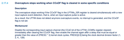

Imen.D
Hello @dhs,
Did you check the STM32U575 errata sheet in LPTIM section ?
Maybe you have the same condition here:
Thanks
Imen
Hello @Imen.D
Yes, I saw it and I followed the workaround, but the problem persist.
To reproduce the issue, all pulses must arrive while the STM32U575 is in stop mode 2
Initially. I encountered this problem with a custom board using a STM32U575VIT6Q, LPTIM 3, after that I reproduce the problem on the Nucleo board using LPTIM 1 and 3.
I'm amazed how such a basic feature can fail.
