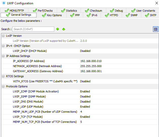

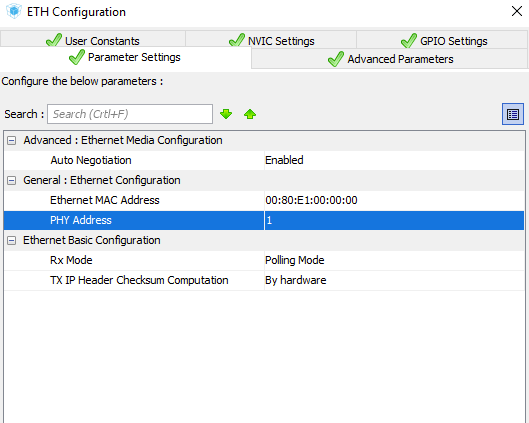

i'm a new nucleo user and I start to play with the F767ZI. I will usethe nucleo for send periodical http get request to a remote server, but till now i have some issues with the tools. I configure cube enabling ethernet (mii) and lwIP library.
I configure on cube static ip and all network parameters, enable ICMP request and then put MX_LWIP_Process() in while loop. However i can't ping the board from pc and wireshark doesn't see anything.
All the examples provided by the repository are made without cube and try to export that examples is hard for me. Anyone could help me? For the first step i'm happy if i can ping the board from the pc.

I attach my code and lwip and eth cube config screen. I can't understand why it doesn't work.
Thank you!
