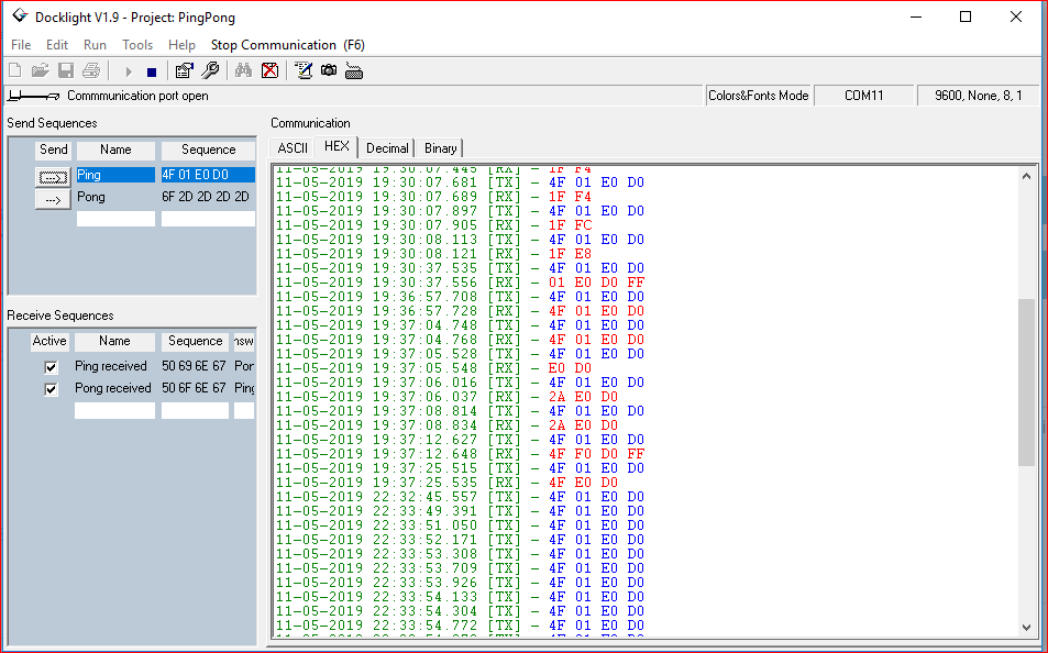

In AVR microcontroller I had communicated this device successfully, part of code ..
//////////////Avr code///////////////
void pump_on_s1_on_s2_off(void)
  USART0_WriteChar(0x4f);	//command
  USART0_WriteChar(0x01); //size
  USART0_WriteChar(0xE0);//data
  //USART0_WriteChar((0xFF-(0x4f+0x01+0xE0))+1);
  USART0_WriteChar(0xD0);//checksum
In docklight terminal, my command sequence is <4F><01><E0><D0> and also succeeded ..0690X000008BZOsQAO.png

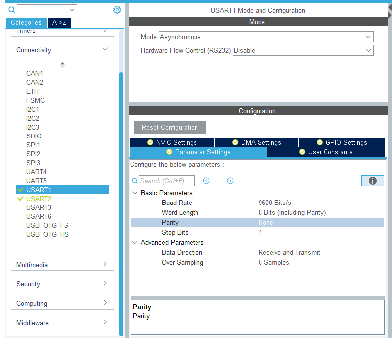

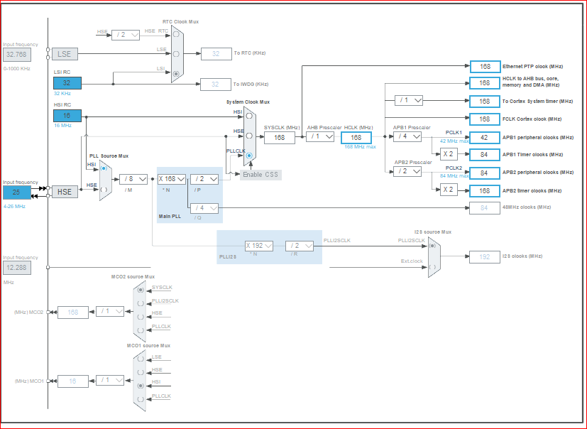

In STM32, I am using CubeMX to generate the code with 168MZ highest frequency
and my programming is

void SystemClock_Config(void)
  __HAL_RCC_PWR_CLK_ENABLE();
  __HAL_PWR_VOLTAGESCALING_CONFIG(PWR_REGULATOR_VOLTAGE_SCALE1);
  /** Initializes the CPU, AHB and APB busses clocks
  RCC_OscInitStruct.OscillatorType = RCC_OSCILLATORTYPE_HSI;
  RCC_OscInitStruct.PLL.PLLSource = RCC_PLLSOURCE_HSI;
  RCC_OscInitStruct.PLL.PLLM = 8;
  RCC_OscInitStruct.PLL.PLLN = 168;
  RCC_OscInitStruct.PLL.PLLP = RCC_PLLP_DIV2;
  RCC_OscInitStruct.PLL.PLLQ = 4;
    Error_Handler();
  RCC_ClkInitStruct.APB1CLKDivider = RCC_HCLK_DIV4;
  RCC_ClkInitStruct.APB2CLKDivider = RCC_HCLK_DIV2;
  if (HAL_RCC_ClockConfig(&RCC_ClkInitStruct, FLASH_LATENCY_5) != HAL_OK)
    Error_Handler();

  huart1.Instance = USART1;
  huart1.Init.BaudRate = 9600;
  huart1.Init.WordLength = UART_WORDLENGTH_8B;
  huart1.Init.StopBits = UART_STOPBITS_1;
  huart1.Init.Parity = UART_PARITY_NONE;
  huart1.Init.Mode = UART_MODE_TX_RX;
  huart1.Init.HwFlowCtl = UART_HWCONTROL_NONE;
  huart1.Init.OverSampling = UART_OVERSAMPLING_8;
  if (HAL_UART_Init(&huart1) != HAL_OK)
    Error_Handler();
  /* USER CODE BEGIN USART1_Init 2 */
  /* USER CODE END USART1_Init 2 */

  huart2.Instance = USART2;
  huart2.Init.BaudRate = 9600;
  huart2.Init.WordLength = UART_WORDLENGTH_8B;
  huart2.Init.StopBits = UART_STOPBITS_1;
  huart2.Init.Parity = UART_PARITY_NONE;
  huart2.Init.Mode = UART_MODE_TX_RX;
  huart2.Init.HwFlowCtl = UART_HWCONTROL_NONE;
  huart2.Init.OverSampling = UART_OVERSAMPLING_8;
  if (HAL_UART_Init(&huart2) != HAL_OK)
    Error_Handler();
  /* USER CODE BEGIN USART2_Init 2 */
  /* USER CODE END USART2_Init 2 */
