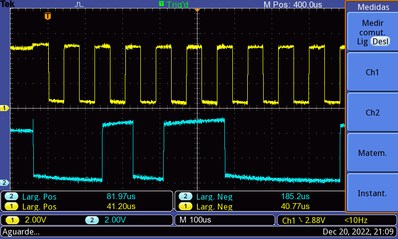

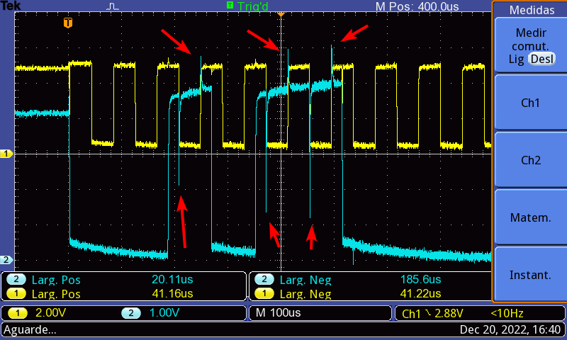

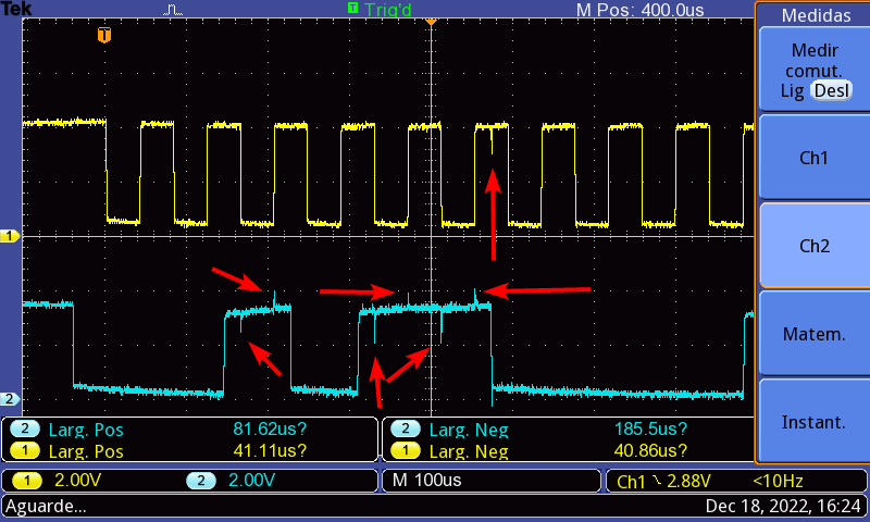

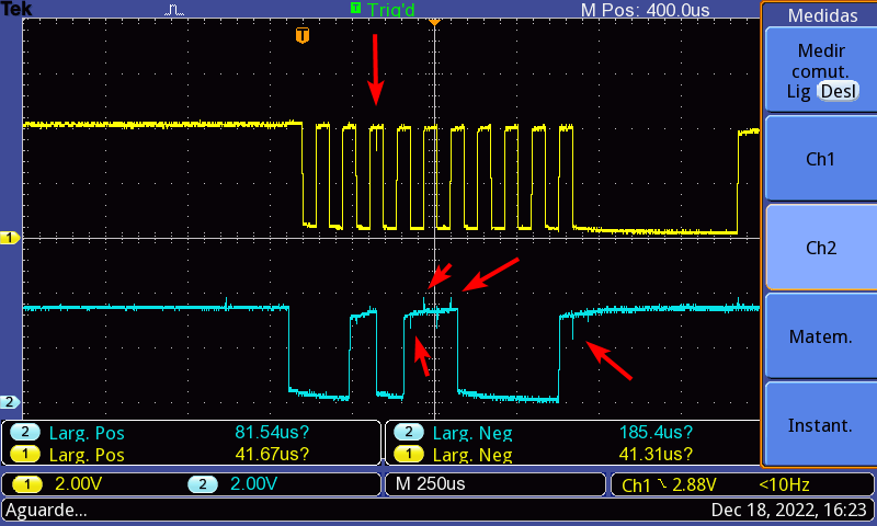

Hello guys, I have a problem with my project. I'm development the PS/2 (device, keyboard-like) protocol with my STM32F103C8T6 (Bluepill). When i convert my port to the open collector output, the noise appear in the PS/2 bus. In this moment, the STM32 controll de clock/data bus. I used open-collector to control de bus. I have a 10K resistor to pull-up the bus.
For exemple: (0x1A data every second)
0693W00000WLT39QAH.png 0693W00000WLT3EQAX.png0693W00000WLT3xQAH.pngBasically, this is my routine to generate the clock and data:

you pics show a strong capacitive coupling between clk and data ( y + cyan) , so separate the lines or screen them separately;
if using a flat cable , try : gnd/clk/gnd/data/gnd . so get some "screen" by the gnd lines.

I'm using the protoboard, maybe it's the low quality of it. I will check this and I return with news! :thumbs_up:
otavio.maciel
The problem is the protoboard! Thank you very much for help! :(
