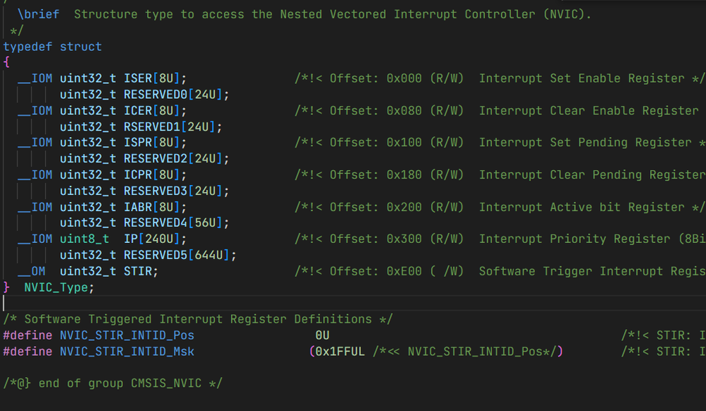

Newcomer questions~Why is there only NVIC with no definition?And where can I find the "user manual" about the Core-CM4 HAL function configure method?
ZeroOne
As titled, with little definition, how do I configure the NVIC_Type struct ? Directly use the numbers that are difficult to maintain later? Or in fact they have official definitions, but they were hidden somewhere else ?0693W00000SvJi8QAF.pngAnd another question, where can I find the "user manual" about the Core-CM4 HAL function configure method? The HAL-user-manual only have the configuration method for stm32 peripherals. It doesn't have the configuration method for core-cm4 peripherals just like how to configure the NVIC peripheral.

You need to look at the “programming manual�? for information about the bits of your stm32 designed by ARM - the processor core, NVIC, systick.
I understand the frustration of having two documents, one written by ARM and the other by ST but it’s just something we have to live with. And don’t forget the data sheet as well.
Hope this helps,
Danish
Programming Manual, or ARM TRM.
IRQ allocations, per device model, should be in CMSIS compliant include files.​

Most of the time you don't have to use direclly the c struct. Use the functions provided by the CMSIS file core_cmX.h, like:
NVIC_SetPriorityGrouping
NVIC_SetPriority
NVIC_SystemReset
NVIC_EnableIRQ
NVIC_DisableIRQ
